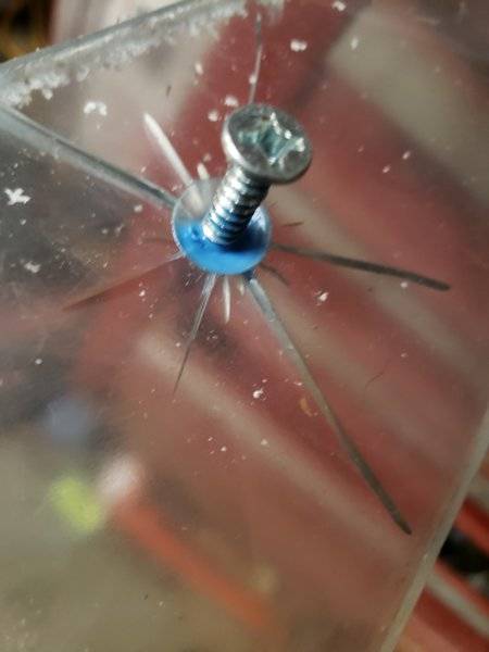

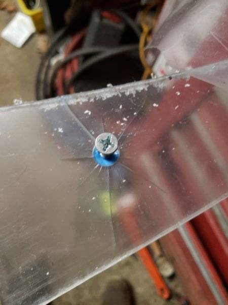

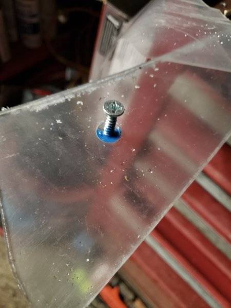

I actually barely have the screws touching the lexan.
When I first installed them, I used a drill bit that was a bit oversized for the lexan to move. Unfortunately, I used the same bit into the sheet metal which caused the loose condition.
When I re did the lexan, I offset the bottom holes from the previous ones.
This time, I drilled the bottom holes in the lexan first, then used a slightly undersized bit for the sheet metal. It was difficult turning the screws down but I feel where I stopped them, they are there to stay.
Like I said, they are barely touching the lexan.
We'll see how it works.
We'll see what happens....
Well, that didn't take very long!

It's not the screw.
I did drill oversize.
It's a chemical reaction with the loctite.

This was just a test panel.
I didn't use the loctite on the new panel.
Loctite expands when it drys I believe and cracks the lexan. Gorilla glue does the same thing. Forgot that earlier.
