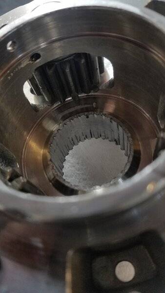

Found the culprit. Stock 1965 front planet. Time to upgrade.
Doug
Am I correct remembering that you've run the stock planetary at Doug-speed for quite awhile?
One thing I’m learning slowly that I’m sure you already understand, Doug, is to look at these things as an opportunity to improve the car. Good luck with the rebuild.

I think the 6 pinion planet out of a Cummins trans will fit,they cost about $50.
