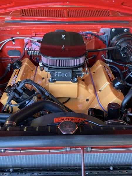

It runs great... Excellent throttle response, no lags, no roughness, just like a modern car... Starts quickly with a twist of the key, hot, cold, sitting for a month, doesn't mater, reach in turn the key to the run position, let the system go through it's process then twist the key to start... It'll start & idle immediately.. You still hear the cam but it's milder sounding.. I live at 50' above sea level & I've had it over 10,000 ft,, It doesn't care, it just runs flawlessly...

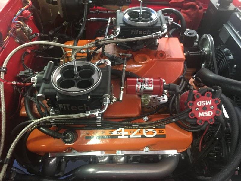

I had my mechanic friend installed the Fitech Go Street 30003 System this past spring, which boosted the 340 up to 400hp. My intake is set up for a 4bbl. Does just like 1wild R/T said above.

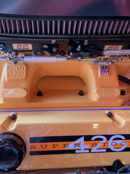

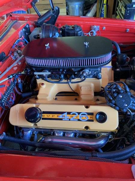

The Mod-Man intake is an Indy Cylinder Head product that has interchangeable top plates. Single 4 barrel, dual four barrel and three two barrels, as well as a couple of different tops for FAST EFI.
I removed my original max wedge heads and crossram and replaced them with the 440-1 Indy aluminum heads with max wedge ports. My original heads and crossram are ported also. I'm very impressed with the Mod-Man on my street car. Instant throttle response from any RPM and pulls very hard. No dyno numbers and no drag strip runs. Kind of miss the crossram look, but like being a little different.
I purchased the heads and intake from Todd Marsh at Marsh Performance and was very happy with his customer service, ethics and attention to detail. I highly recommend him and his business in Linwood, NC: MOPARTS@PTMC.NET
