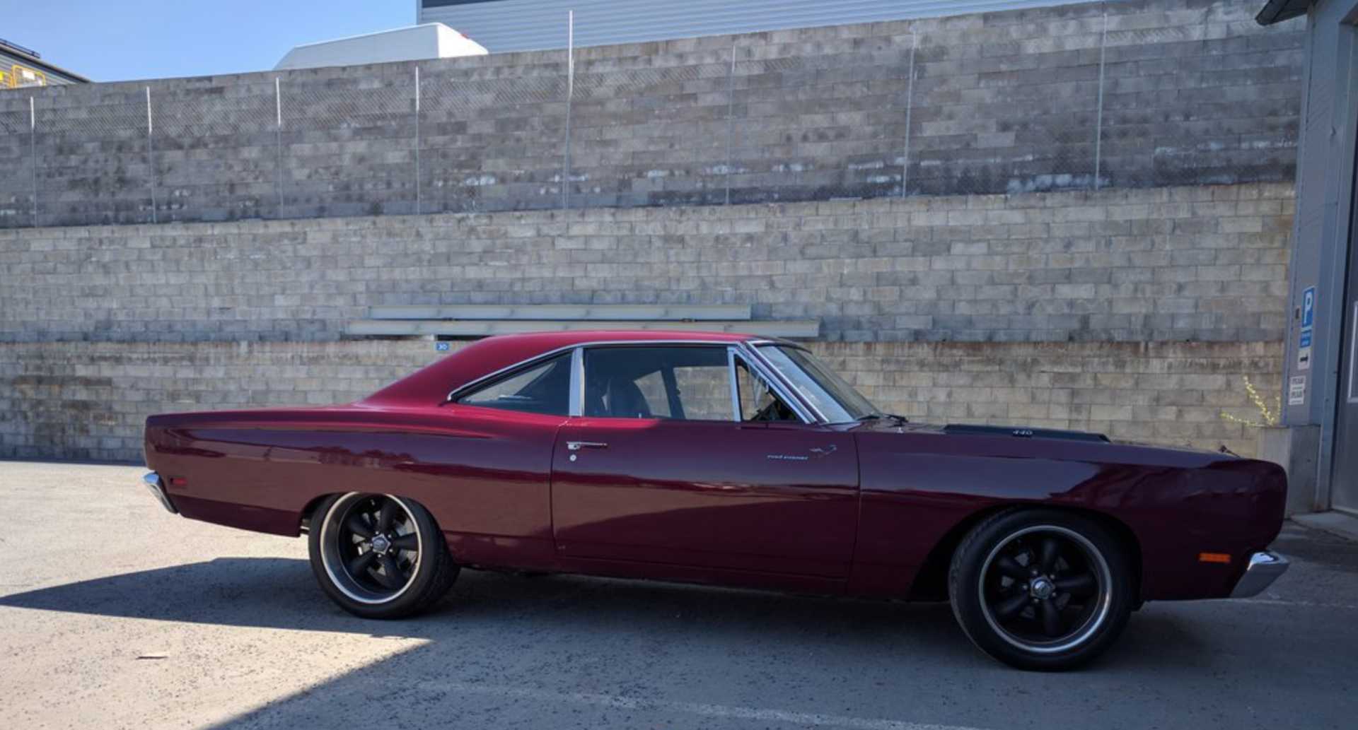

This winter I'm starting the EFI conversion of my 1969 roadrunner and thought that I'd create a build thread to keep track of my progress and if someone is interested in the build - I might be able to help someone.
So. First the car itself:
I went with the mean street for some different reasons and I think it will go along well with the MSD setup that's already in the car

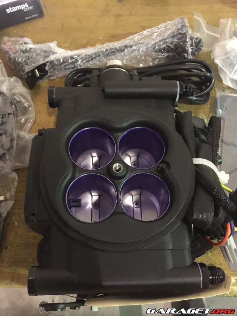

Started to align the unit on top of the intake manifold
Cables sorted out pretty neatly, however there's some alignment issues with the old throttle cable brackets. I needed to massage them a bit in order to go where I wanted. Turned out pretty neatly.
Next step is to clean up the intake manifold because it's really dirty, order a new gasket for the unit since I can't find the included one (I used a friends house as US shipping adress, so it might went missing in the repacking).

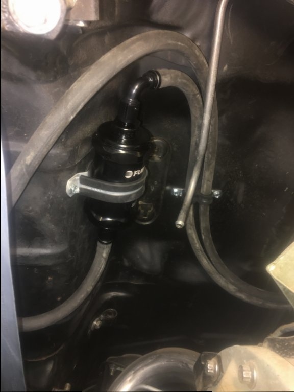

Next issue though. With 60 degree AN6 bends for the fuel delivery, it hits the inside of the filter base, and by looking at it, it doesn't really help to go deep drop filter base - since it will hit even more. So either I go with 90 degree AN6 or reshape the filter base. Any thoughts?
If the 90s will clear, just go that route. If not, use banjo fittings.
Beautiful RR and I like the tires and rim set up. Can you give me tire sizes and offset for your rolling stock? I will be watching this closely as I have wanted a Fitech from the start and really interested in your process. I am in Alaska so the cold start issue is a big deal for me and this should cure that. Thanks for the posts and keep the pictures coming! Mocajava

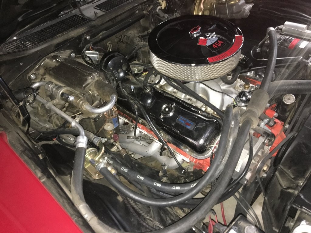

I just installed this unit on a 1970 chevelle. I did not use timing control as it has stock hei and works well.
I also ran -6 feed and return with aeroquip push tite
I used the same fuel labs filter as you.
Thing runs great but I did add fuel and remove decel fuel.
I went. With 3 fittings that are 90 degree throughout the system. Roller cam edelbrock headed 468 runs fine with good afrs
They are 18x8 with 4 inch up front and 20x9.5 with 5 inch in the rear if I don't remember it wrong, can measure them up the next time I have them off. Think they're 295s in the rear and 235 up front.

Alright, so the 90 degree AN-fittings still don't clear the filter base and I can't figure out which Banjo fittings to pick? Can anyone just post an url? :)

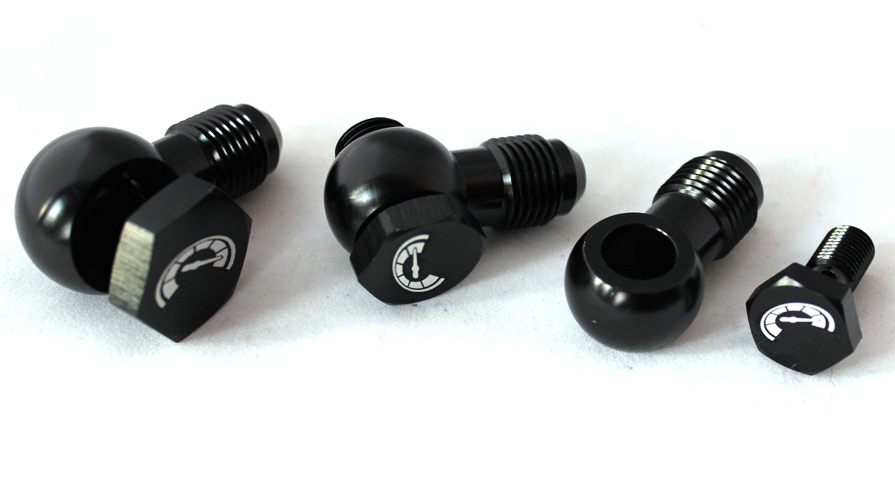

90 degree bends didn't do the trick. And there's no Banjos for 9/16 -24 which the inlet side of the fuel rail is threaded in. Back to the drawing board.
So I looked around and found these for the return side:
Turns out that the return side is M10x1,25 which they make banjos for. So I got one of them with AN6 fitting. Will arrive in a couple of days and set me back another 30 bucks.
Then I figured, there SHOULD be some 9/16 24 AN6 90 degree parts that screws directly into the rail. And there is! https://www.summitracing.com/int/parts/ear-at949094erl
Great - but with shipping and some other small bits and parts it came down to $100 for three small fittings including tax and shipping. Not happening (or so I thought). So I started calling around. Guess what - the only option was to have a local company to buy it from Summit with a 25% mark up... So I bit the bullet and ordered the darn fittings from Summit..

Alright so all bits and pieces has finally arrived and latest order consisted of:
10-1.25 AN6 Banjo Bolt

The outlet port is 10-1.25 on the FiTech and the hole through the M10 banjo looks a bit tiny - but I read others running the same config on the return without any trouble so I hope I'll be fine.
