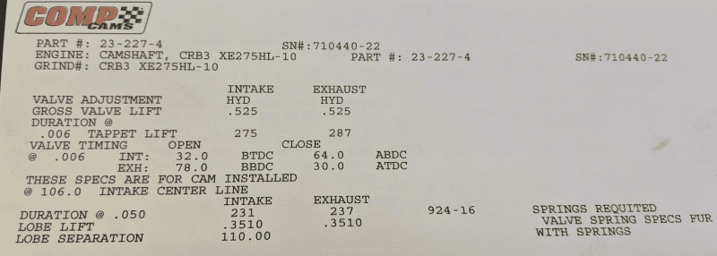

I have a 66 too... built a 440... and put this cam in it. They make the same one for the 400.
I stroked it and then put 240's on and then popped this cam in... and then put 1.6 rockers in.
Granted, I'm going to be putting in a solid roller here shortly... but this is what worked for my stroker.

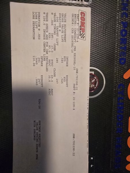

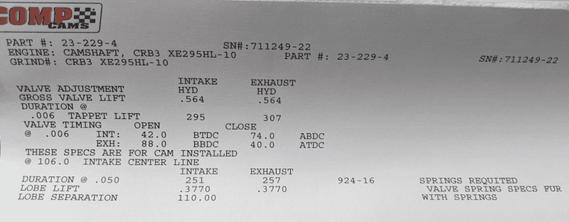

Do they have flat tappet solids in stock? My friend Paul is running a solid, I think over 250 @ 0.050 in his 470? stroker.
I still have the fairly large Hughes hydraulic cam sitting on the shelf that I bought from GTX John. I don't recall the specific size, but I think around 250 @ 0.050" intake duration.
Found the for sale post, 2023. The cam is the HEH-4650.
