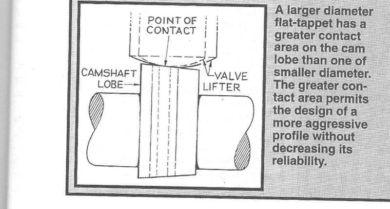

The roller is always centered to the lifter, cam is made to induce lift from center. It rolls up the ramp. Non roller lifters start to lift from the outside edge of lifter (on the ramp face) then move to the center then back to edge. Because of the taper on lifter and on cam lifter never rides on its whole face, if it does it’s wiped. One reason mopars bigger lifters are better over the other brands (smaller diameter) mopars mushroom lifters were designed so as to have more lift and duration then conventional ones (NASCAR mainly because they were not allowed to use roller cams).
More wrong info from Ceedawg in post #107. Non-roller lifters do NOT ride on the outside edge of the lifter.
The crown on the lifter together with the slight side to side taper of the lobe [ 0.001-2" ] means the contact point is inboard from the edge of the lifter. What spins the lifter to minimise & distribute wear is the fact that the centre line of the lobe is offset slightly from the centre line of the lifter.
What is wrong with you? Are you an idiot that just loves to stomp around claiming you’re the best?
Nothing I’ve said is wrong especially the part about circumference measurements or the ‘edge’, lifter cant turn from center. WHY do the Chevy guys want the bigger diameter Mopar lifters? To ride in close proximity of the center? Now IF your picture is showing how they make lifters and cans now, there is the problem of wiped cams. Please educate yourself before spewing out stuff you read on the internet. BTW look at any wiped lifter, is the ‘bowl’ in center over does it cover the entire face? Look at the wear pattern of any old cam, on the edge back to center. I’ll agree lifter is not all the way to edge but it’s farther out than that generic picture you put up. Cam placement in block is another issue for further dissusion.
