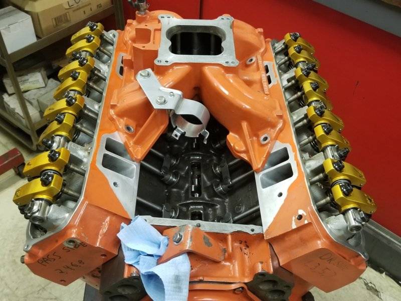

Isky built the cam-rollers and rev kit for my engine (70s) the rev kit (springs over push rods to a rack under heads) on a general look see I found my valve springs had many 10 pounds seat pressure, I could turn retainer with thumb and finger. Engine had been turning 6800 like that. I changed springs that day.The lifter and pushrod weight don't seem to influence much as it's moving 1.5 -1.8 times slower and less distance than the valve side. (whatever the rocker ratio is)
Oh I’m glad I found it out before but the rev kit did save that engine.. those springs had considerable strength, the Max heads had no heat crossover so I made a stud to hold the bracket square in that spot.Not a fan of rev kits myself nor do I think weigh matters on the lifter.
I see high end titanium valves. I've never seen a titanium lifter.
As for turning 6800 with a rev kit and 10lbs on the seat, I think it would be very unhappy and your pistons were probably closing the valves.
