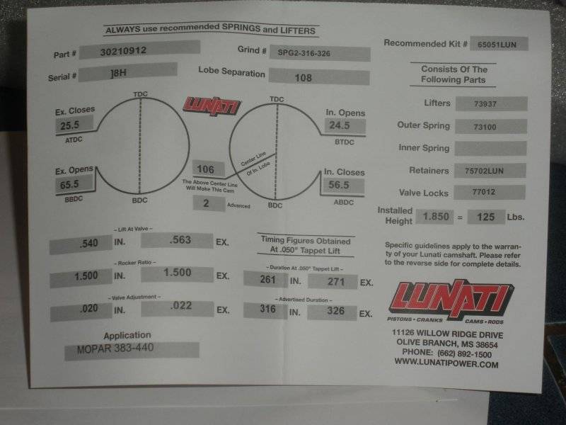

I'd run a solid FT again if I thought it might run a little quieter than what I have now. For the record, here is the cam cars for what I'm running:
I bought this cam on the advice of a FABO member that was trying to help me bleed off cylinder pressure to eliminate detonation. I've learned since then that is a poor shortcut that rarely works. The cam is way bigger than I need. I also have 1.6 ratio rocker arms so the lift is actually .576 intake and .600 exhaust before deducting for lash.

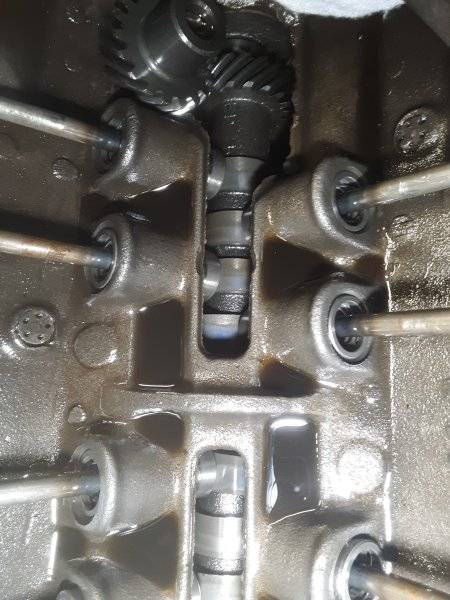

Today I tore down a 383 that a FBBO member gave me. I marked lifters and pushrods with a white crayon and had my friend Rich watch them as I spun the engine by hand with a long bar. I wanted to watch lifter rotation. After I had my first cam failure, I was told to make sure the lifters spun in their bores so I would test all the lifters in the engine but I never tried it with the cam in place and the engine rotating. It was wild to see the lifters stay almost still until the lobes started to rise, then the lifters would spin maybe 1/5 a turn, then stay almost still until the lobe ramped up again. I expected that with lobe taper that the rotation of the lifters would be linear and constant. The pushrods barely spun.

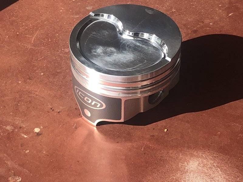

I did run it with stock rocker arms and then with these 1.6 arms. Back then I was fighting the detonation but since then, I am using dished pistons....
