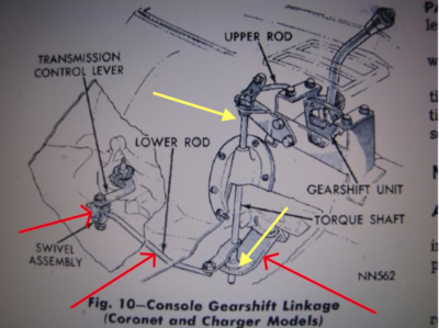

For a ‘68 Charger with floor shift. Are 2 bushings required? My original appears to have just one.

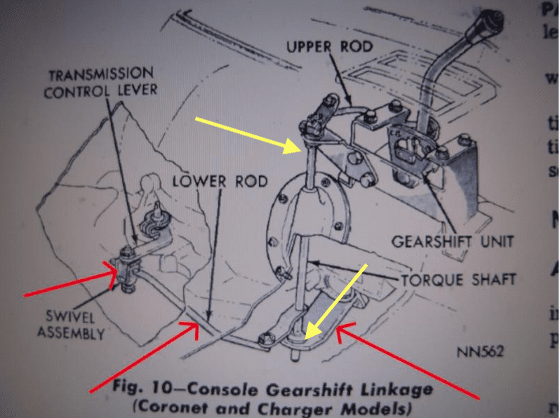

Should be one in the bottom bracket as shown and one in the top bracket inside the car...
Ignore the red arrows, the yellow arrows are the bushings..

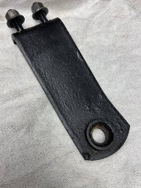

One in the bracket you show.
a 2nd one is in the shifter linkage under the console BUT linkages are welded together so the upper bushing is not servicable ,,,easily
