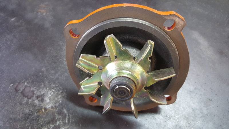

Just wondering if anyone has purchased one of these water pumps and is one better than the other
I have a Flowkooler on my 63. Made a noticeable difference and combined with a aluminum radiator, it solved my overheating problems.

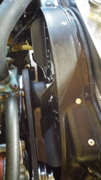

I put a Flowcooler pump on the 400 in my Barracuda, but I also got rid of the small cross-flow radiator with electric fan and replaced it with a 3 core Champion, correct shroud, high volume thermostat, and mechanical fan. Unfortunately, I did it last fall, so I didn't get a chance to drive it in hot weather.
I can say the whole system works much better now. Before,... You couldn't see any evidence of the system working, it would just heat up and continue to get hotter unless you were cruising down the highway. Now, I can run it for an hour with no overheating issues. Temp comes up to about 180 degrees (with 180 thermostat), thermostat opens and temp drops back down until thermostat closes, then cycle repeats.
Like I said though,... this was at about 70 degrees outside, so I haven't been able to test it in hotter weather. Looking forward to testing it out this spring/summer. Here's some pictures of what was in my car when I bought it, and what I have replaced it with.

Wondering if this Flowkooler pump will work with the 440source housing? I am kind of stuck since I bought the passenger side outlet housing originally. These flowkoolers seem to solve the at idle in traffic overheating issues since they flow 100 times better due to the impeller design. Just hop the housing I have isn't the bad one with the small orifices.
Just a word of research - the 440source passenger side outlet aluminum housing has the same holes as the factory pump I was finally able to compare them side by side. That said the drivers side outlet is smaller. however overall the housing to get if you can find a decent one is the 73-78 one if you are running passenger side outlet, these years have a bigger opening in the center looking down through the thermo hole and flow allowing better less restricted flow. thinking of just getting one from ebag.

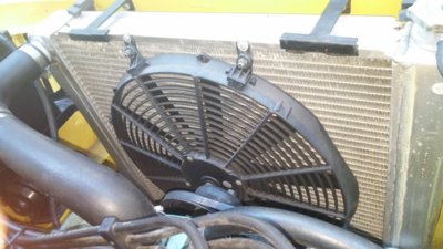

Well lets see...got the Flowkooler installed, ran some of the Sumitt coolant and Got out this morning with 70° temps. It went well ok? Got up to temp pretty fast 180-190 took it out on the freeway for about 5 miles at 65 then pulled off and ran down city streets light to light for about 6 miles. Now i use both factory guage and a mech one. The factory gauge showed just short of the right middle mark. Hard to desctibe but the guage has a cold / off mark than a section were i would assume it is its operating range. About a 1/4 way left to right starts it then at the 3/4 mark it ends the range. So the temps stayed just short of the 3/4 mark which would be within operating range? Now the mech guage showed about 185-210 most of the time it was at the 190 mark. Seemed hot for the temps outside. Is it me or should my temps be 180 when its 70° outside? Repeated the same event when it was 85 out and basically the same thing. Took out some of the Sumitt coolant and put in some zerex G-05 and ran it in the garage for 15 min. Temps sat at the 3/4 mark or 190° the whole time. Interesting note while at a light i could see the gauge drop a little. Then would go back up cruising. There was a time when i would run at 180 on cool days.
Not sure if i should be concerned? Could be a tune issue too. Just seem to remember running 180 all the time unless it was over 90° outside then that was a different story.
Thinking i may have found a balance finaly not sure.

My set up is this
160° Mildon high flow stat ( interesting note Mildon high flow stats have a small notch or hole built into them for air relief i guess)
The Flowkooler pump
440source passenger side outlet aluminum housing same port size as stock
26" aluminum ECP radiator 2 row 1" tubes
16 lb cap
Twin 12" electric fans with shroud pulling 3500 cfm
Timing at 10° inital 35 total
9.6:1 compression ratio.
One thing to note is the fans cool things down pretry fast. However i noticed they are pulling in super hot air into the engine bay so much so im not conviced my mech gauge is reading accurately. I noticed the temp gun reading at the stat housing would read one temp with the fans running but blocking the hot air with something gave a bit of a cooler reading. Note to self lazor heat gun reads hot air too.
