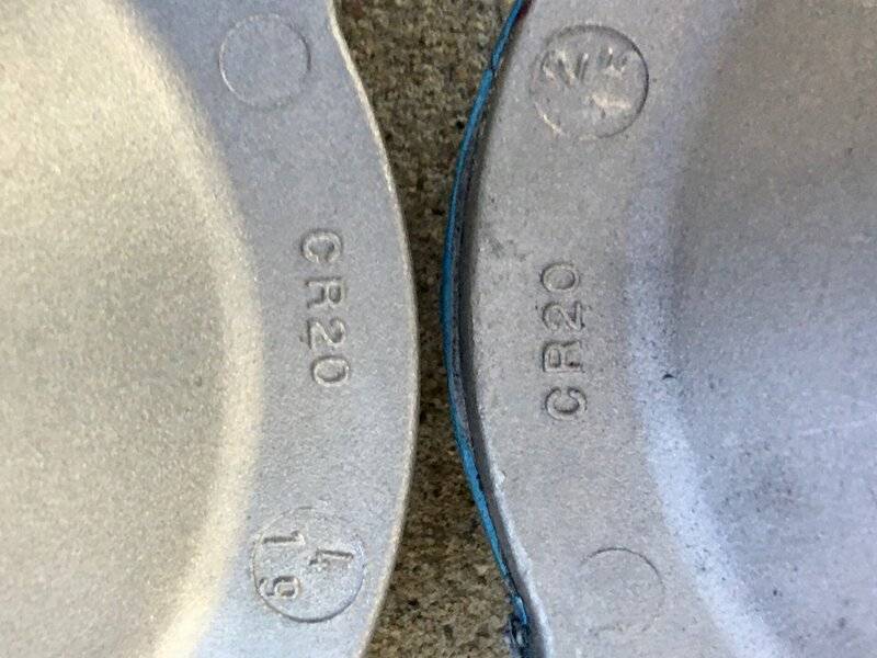

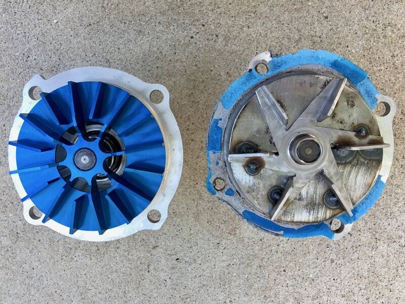

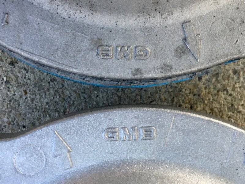

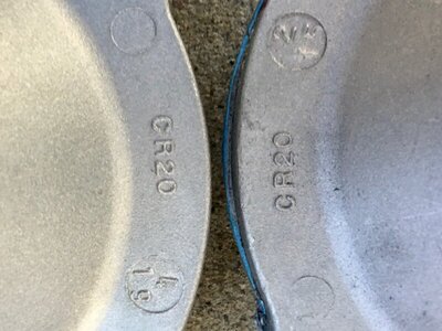

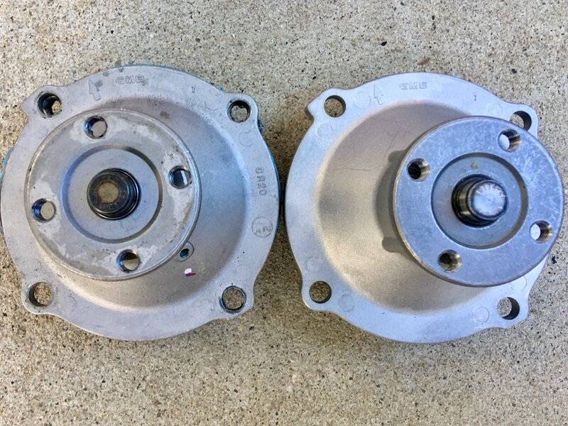

I'm not attempting to bash anybody trying to bring innovation to the hobby, I just took some pics of something I noticed while swapping pumps last night. The FlowKooler I got a couple weeks ago is just a GMB aluminum housing (even says on the snout) with the FK impeller. I've seen that a lot of aluminum castings are virtually identical and various logos are cast in it for a run, so no surprise they used an existing casting.
The pump I had on it is a GMB I got for about $32 and I made my own anti-cav plate and presto! I made a Milodon HV pump. I guess I can always press off the FK impeller if I ever need to swap it out with another $30 housing.
It's going to be 90 degrees today, I'll try it out. My temps weren't that bad but my battle with detonation was also a battle with heat. I won but that's another discussion.
