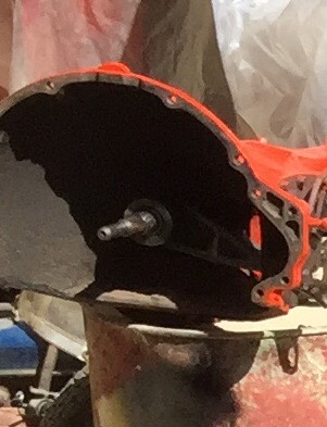

Can you post of pic of the nose of the input shaft....side view and end view please.....
sorry this is the only photo i found for the transmission , it looks original not cut to me . also can my current flywheel be balanced to be used on my 400 ?( i've been told by an old mechanic man who used to race a Hemi Charger that it could be done at a machine shop ) it's kinda of stress relief to hear if that true lol very thankful for your help, much appreciated

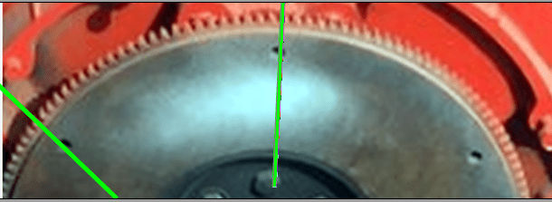

You do have an 11" flywheel in that picture. If it's balanced for the rest of the team it's OK to run. Pedal pressure is typically a result of pressure plate load differences, not diameter of the clutch.
24 teeth X 6 = 144 teeth, for Mopar is an 11" flywheel.........
.....a 10-1/2" flywheel will be 130 teeth. 21.5 teeth between bolt holes.
