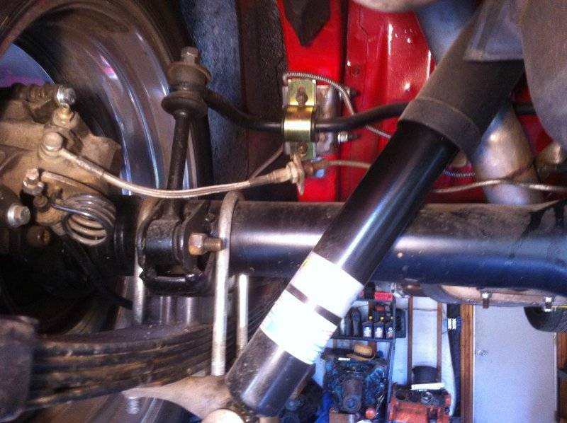

I welded a bracket to the axle housing instead of using the add on plate like the Firm Feel bars.
The gold colored D mount bracket is aftermarket. The natural finish brackets are OEM Chrysler.
It clears the differential just fine. Eventually, I want to redo the end links.

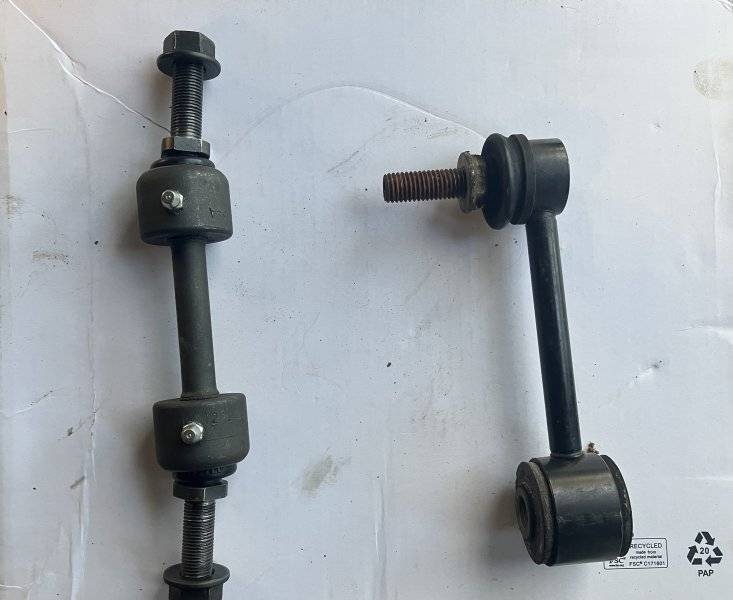

These are crude and sloppy but they work. I think I'll modify these:
I could cut the loop off of the one on the right and weld it to the bottom of the one on the left. I'd then have a loop on the bottom and a swivel on the top, no bushing.
These pictures are great and I like how you did the axle bracket - looks factory to me!
As for the end links, have you thought about using heim joints for the axle attachments? Or would this transmit too much noise/vibration to the body?
Anyways your post will effectively raise the demand for FMJ rear sway bars!
I've posted about it before. The cars have really thinned out over here on the West Coast. I'd grab them at the junkyards if I saw them but THIS one is the last one that I saw and it has been about 10 years.
Heim joints? No way, man. I don't like them for street cars. They cannot retain grease and don't do well long term.
The links that I posted are ball jointed with Zerk fittings to grease them. I have them on the front sway bar and they make no noise. The simplest is the standard strut links with bushings whether they are rubber or urethane but with those, the bushings wear, deflect and shrink leading to free play. These ball jointed links are a huge step UP !

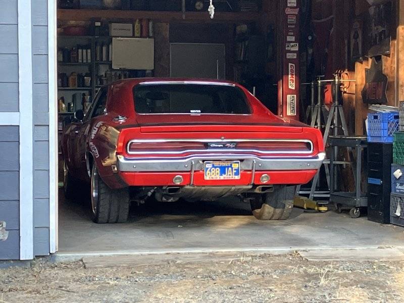

I had previously put a Diplomat sway bar in a 73 Duster around 1996 and I had figured that it might also fit the Charger. In a stroke of luck, it fits as if it were made for the car. I had an Addco 7/8” axle mounted bar and didn’t like it. The car was twitchy and wanted to hang the tail end out on rapid turns. The 7/8” size was too much. I pulled the Addco bar and drove the car around a bit and felt that while it did handle well, it still had some body roll that I didn’t like.
The FMJ rear bar is just shy of 3/4” and the lever arms are slightly longer which lessens the rate a bit due to leverage.

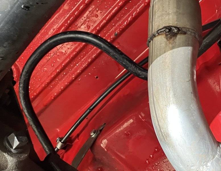

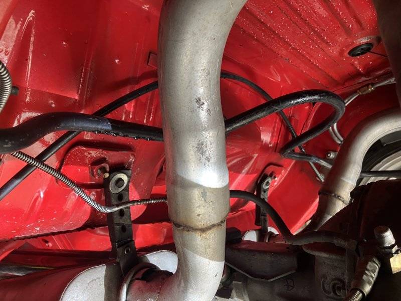

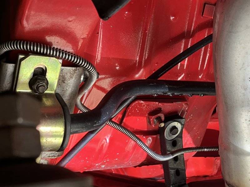

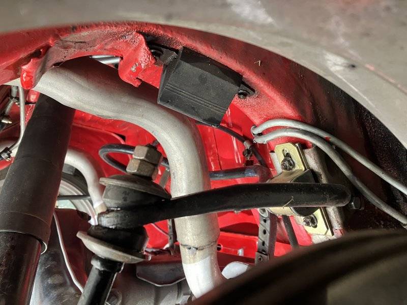

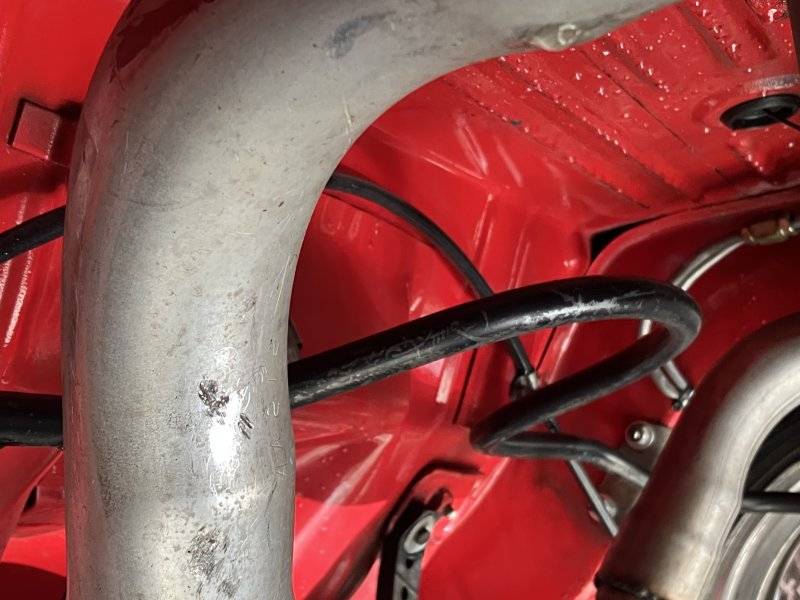

This one slipped right in….

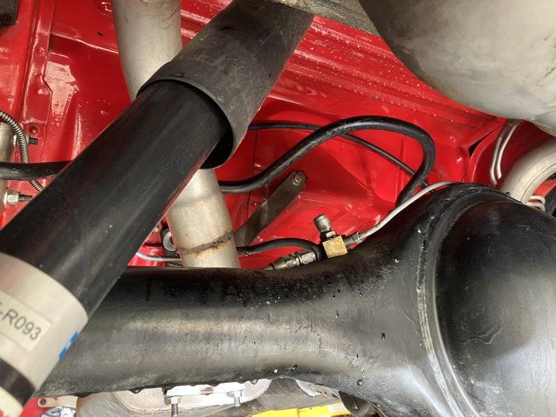

Note how the half loop moves with the axle to clear the differential.

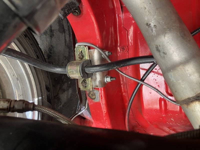

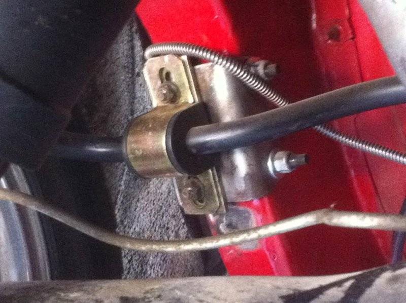

The mounts fit great.
This never hits the body.
You can see how it steps in from the frame rails.
Again, the end link is where I still need improvement.
The car is up on the lift at the moment so the axle is at full droop here.
Cheers.
Thanks again! These pictures are great! I only need to figure out the axle mount as I want to use the same ball joint end links you posted above - in order to do so the sway bar eye should be level to the the axle. Have to check but maybe I have to move the axle mount closer to the axle itself or even on top and use really short links.
