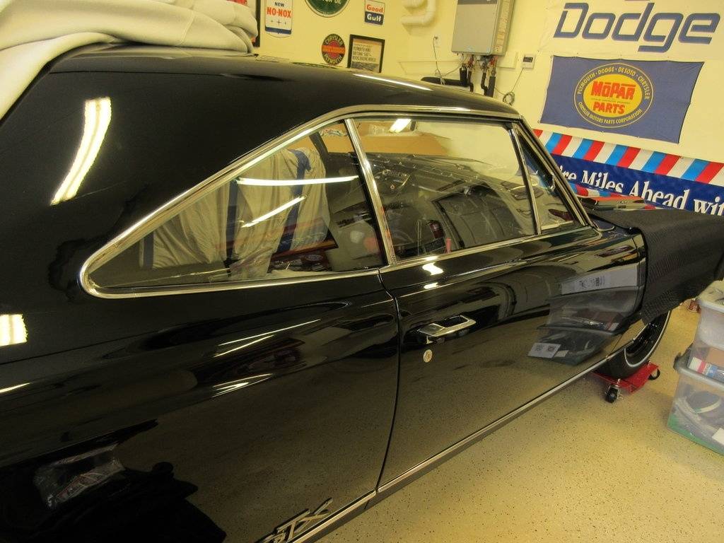

Goes to show two things:
1. ECS glass has been high quality reproductions and factory like and fitment
2. If the installer knows how to install the glass, everything fits perfectly

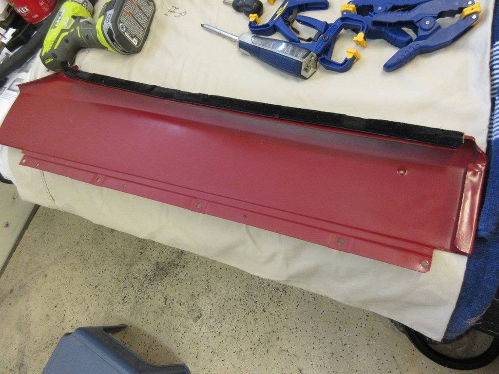

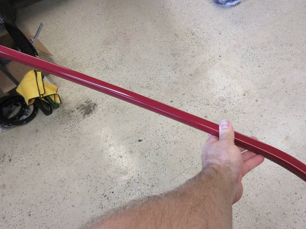

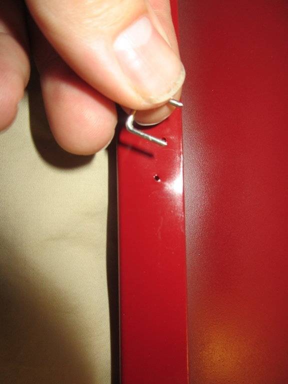

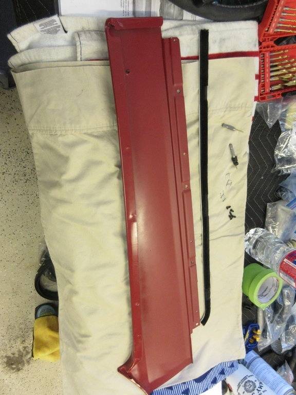

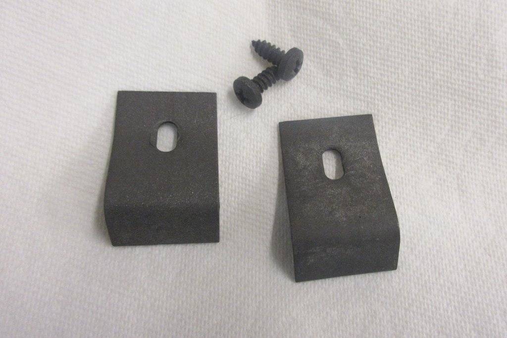

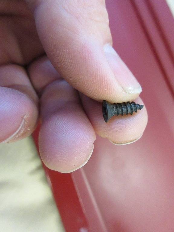

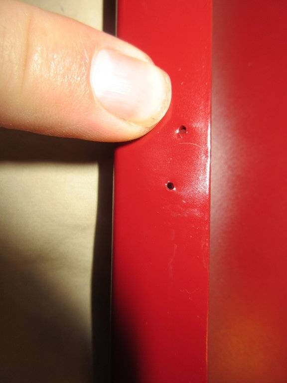

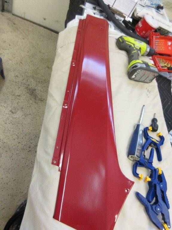

Passenger upper door pad. Installing the fuzzies. The originals used staples which these came with but when I asked the company how to staple them? The tech guy said, "I do not know?" lol I asked so you sell them like this but do not offer a tool or advice how? WTF
So I did them as I have done and that is to use small screws...

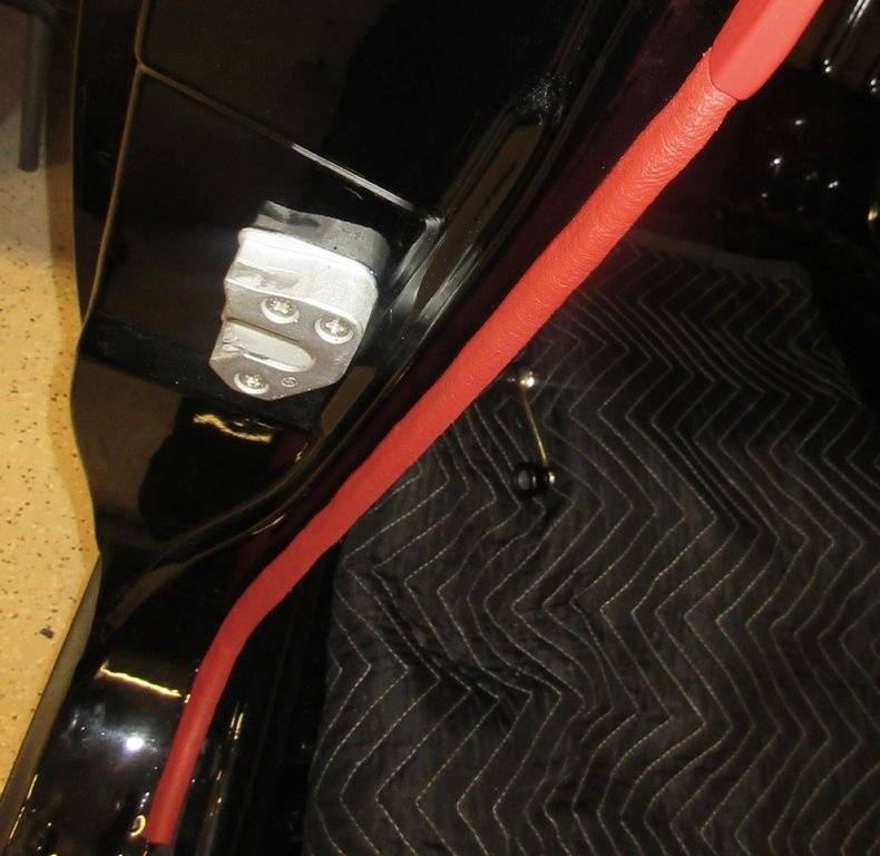

Interior roof rail trim and the upper arm rest panel installed.

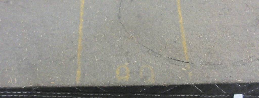

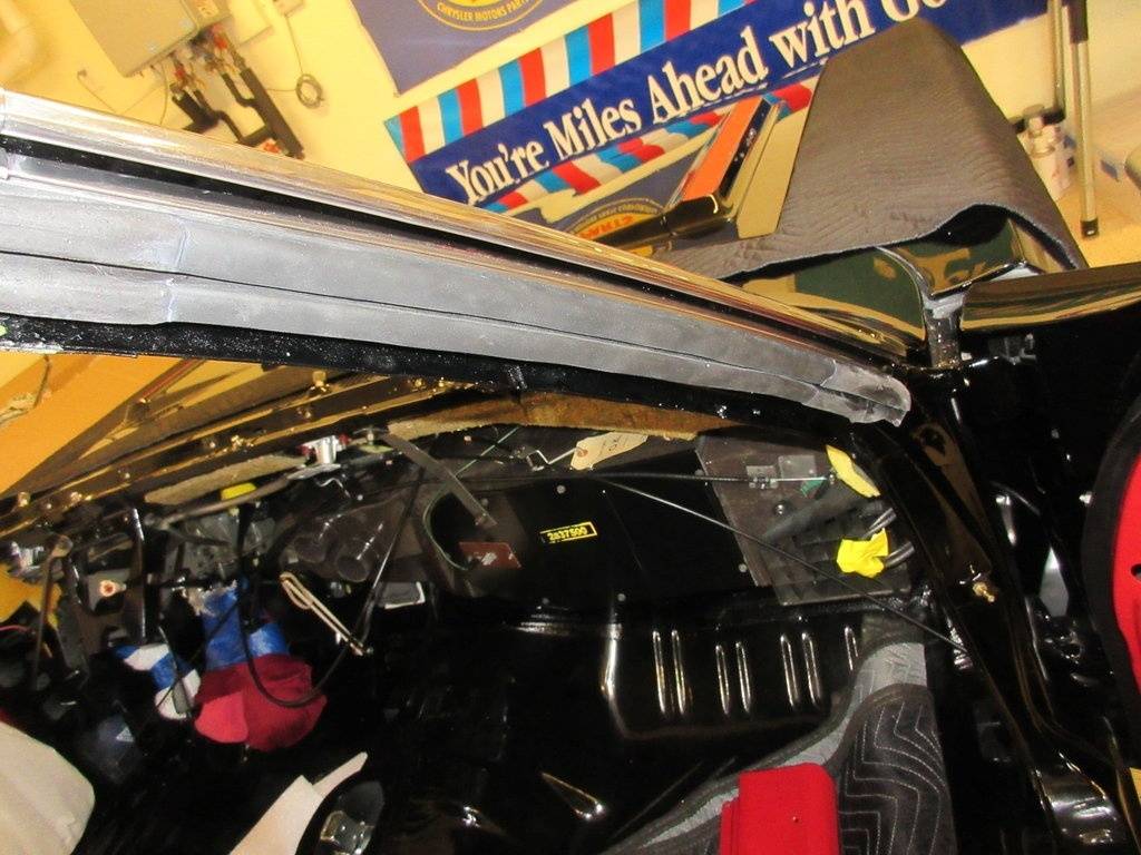

Rear package tray. I was able to acquire an original factory package tray from a 69 charger that had the correct factory insulation. Of course the sizes are different so I had to manipulate what I had to cover all openings properly below the package tray. So if someones looks from inside the trunk up they will see the correct package tray insulation...
The fabric tabs on the package tray were glued to the frame with the yellow weatherstrip adhesive just like the factory sloppily did....

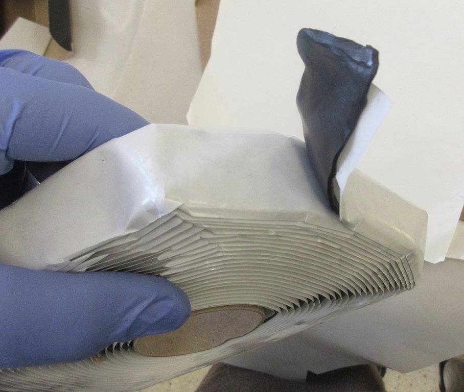

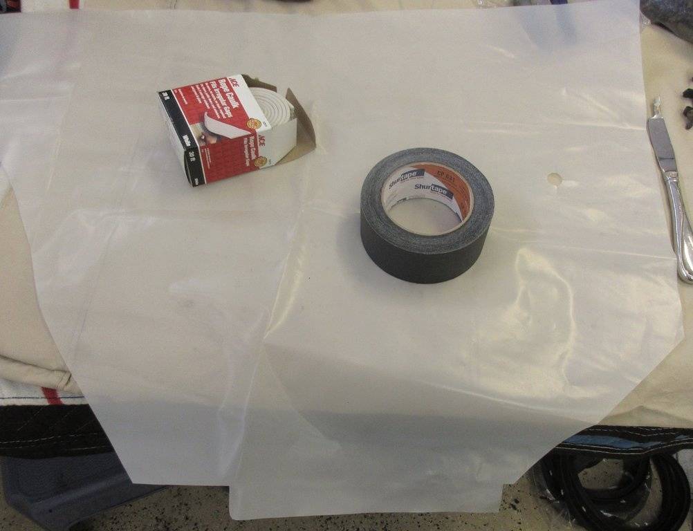

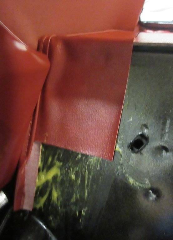

Here is a handy tool that can be easily made with a household utensil. This tool is to create a sleeve in the cardboard on the door panels to accept the clips. The key here is to move slow and twist L and R forward with your finger underneath applying up pressure. If you do this method you will not have dimples show when you install them. The clips are NOS. The white rope caulk goes on the rears to hold the moisture barrier in place and the tape is the correct factory type.
The moisture barriers, rope caulk and tape came from PCG....

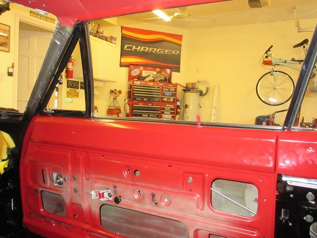

The last pic is rope caulk tape. About a 1" square was placed on both sides of the rear window mechanisms body frame. The next pics show where they go....

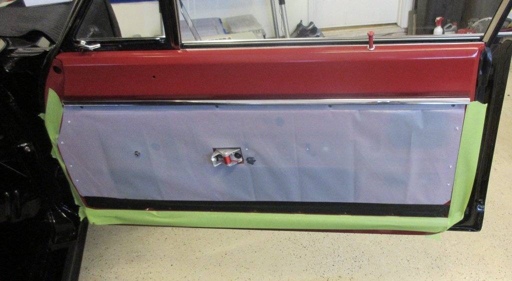

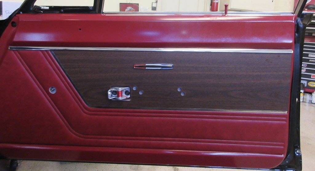

Front passenger door panel prepping. You this is what irritates the sh** about me with reproduction parts. Bad enough the rear panel I have to finish the cutout on the window crank hole, door pad screw holes and every place a clip goes but now I have to add ones that should have been there. The driver panel had to have two clip recesses added....BS

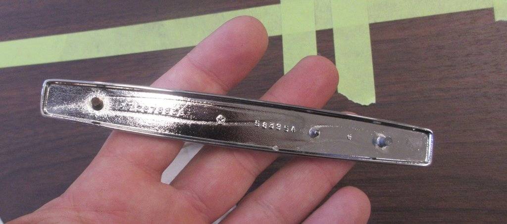

The door panel emblems are originals that Paul's chromed and TA painted. I got the measurements from Dennis at kruisin moons to place them in the correct position. Of course Legendary offers nothing. I attached them using 5 min epoxy...
Front passenger door panel is installed, Tape is cheap, paint is not! Original door plugs...

When I did the window fuzzies on my 62, I clamped the fuzzy to the panel and used a small drill bit to drill the new staple holes then crimped with an angled set of pliers.
On my GTX, I left them alone because, 1. They were still good and, 2. I remember how big a pita it was to do lol
I was tempted to do the same thing but the staple was relatively short and that is the critical part. It would have to be compressed and crimped and that is what makes it a PITA....
Years ago I tried it and said screw that technique, lol....I believe they used and air stapler back in the day....Once the crews are in deep enough you cannot notice nor could you even notice the staples....
The screws are the easier route non the less...

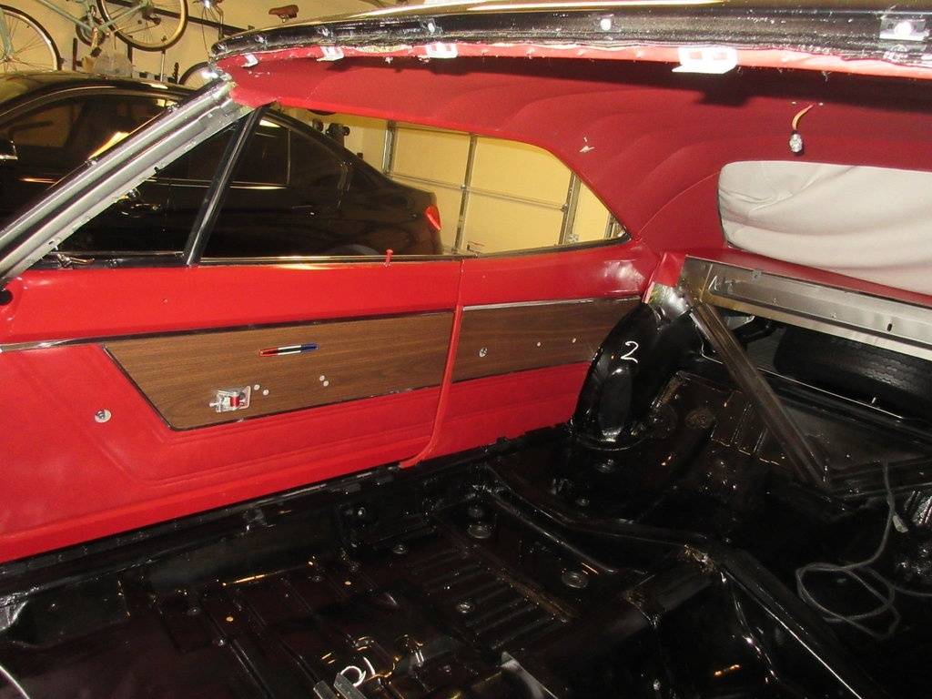

Passenger side done....Windows roll up and down with ease and all edges meet/seal...However there will never be a water test, lol...
Window cranks, inner door handles, armrest pads/bezels will be one of the last interior items installed....just in case Eagle eye notices, lol...

Question? How does the plastic barrier attach under the door panel? Butyl tape?
