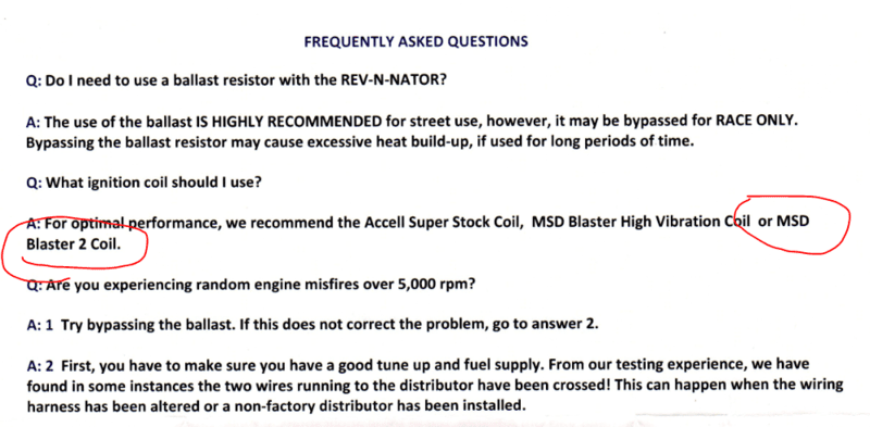

I used the MSD Blaster II as recommended, with zero issue.

An excerpt from the instructions that came with Unit #666 Black
FBO
This is a Plug & Play unit, mounts in standard ECU holes and plugs into Mopar Harness. Must be used with FBO HRR Coil (Pertronix 40011). Extended use of a coil with a non-compatible Primary resistance and not designed to run on a 12V system may cause the box, coil or both to fail.
DO NOT USE BLASTER, Accell, E-core or Mallory COILS!
Correct and matching Coil is the Pertronix 40011 available at all FBO dealers or O'Rielly's/Autozone Nationwide.

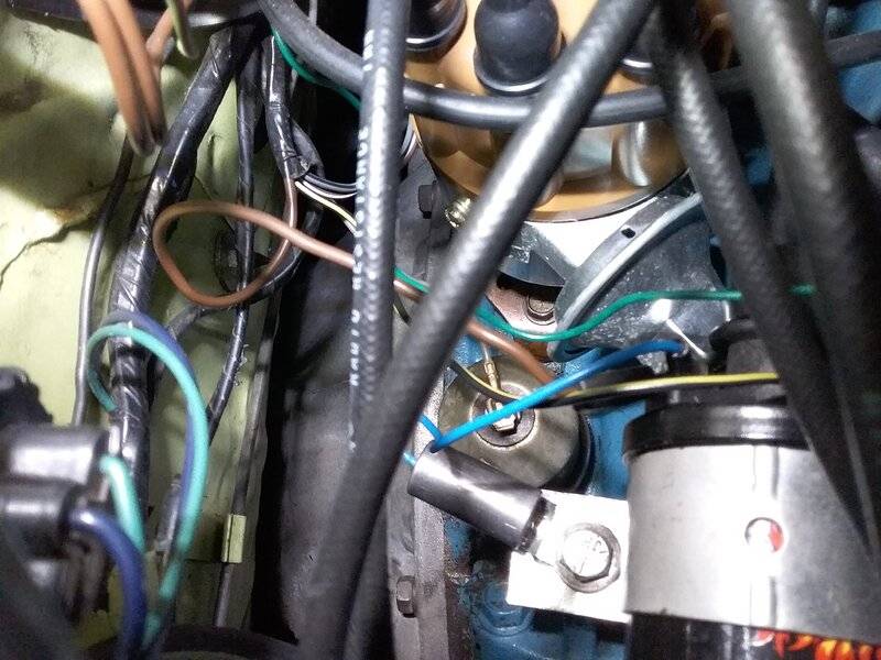

I Purchased the complete kit, distributor, coil and box. The system performs as advertised, better starting and idle, no more smelly exhaust, smooth acceleration too.
Better power too. Do exactly what it tells you for the settings.
I have a 73 318 two Holley 2280. The engine wa re-built with a Mopar cam .430 inch lift. I always had it set for about 17 on the fly wheel, and with this dist set for 18. For a total 35 degrees. at idle it is about 31 to 32 degrees at idle 925 rpm, 22 hg of vacuum. Very efficient. with vacuum advance connected to the intake not the carb.
The car has never run better, I also use Bell fuel additive for the ethanol correction.
