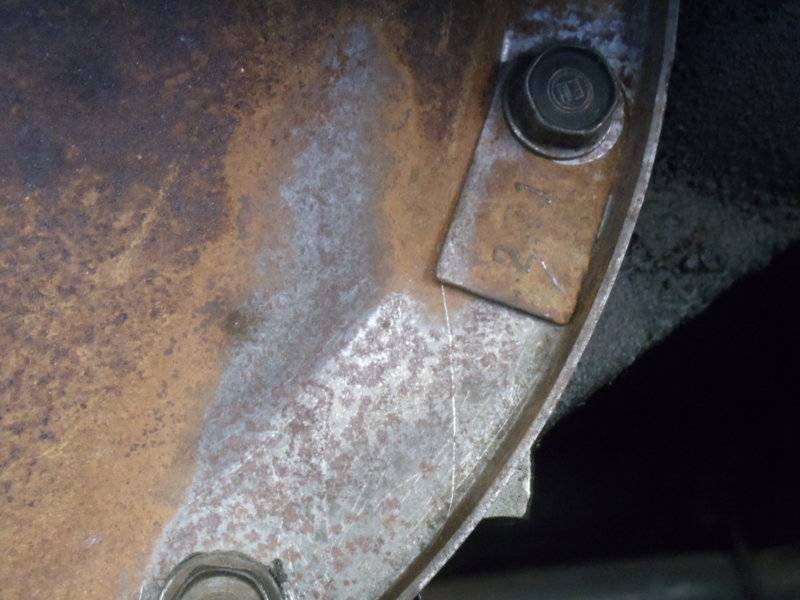

I have issues with speedo accuracy on my '72 Satellite Sebring Plus. To begin tracking down the problem, I need some verifiable factory specs. I already found the "2.71" tag on the differential. Now I need to uncover what standard tire size the factory supplied for a '72 B Body with 318/Torqueflite. Surely someone has an old door sticker with the information I am looking for! Thank you.

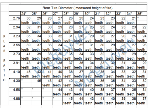

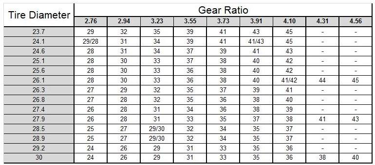

All you need to do is know the tire height 24 25 26 etc etc. And the gear ratio. Then use the chart for speedo gears. What size tires are you running?
