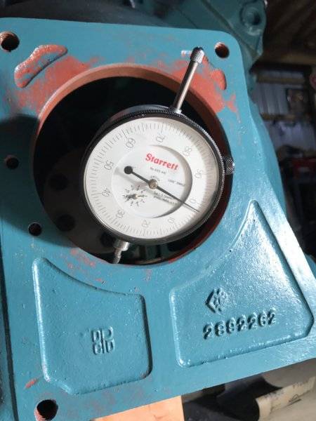

Definitely align the bellhousing as has been said. I used Robbmc offset bushings to dial mine in.

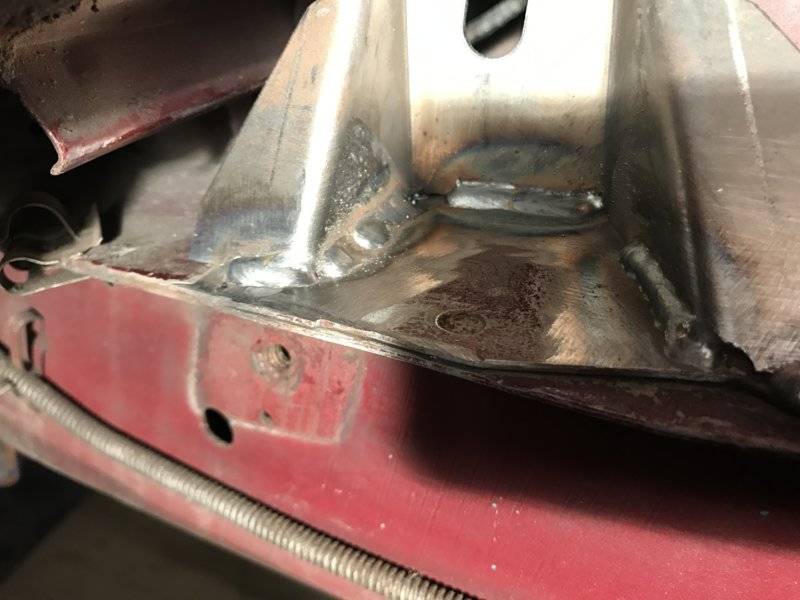

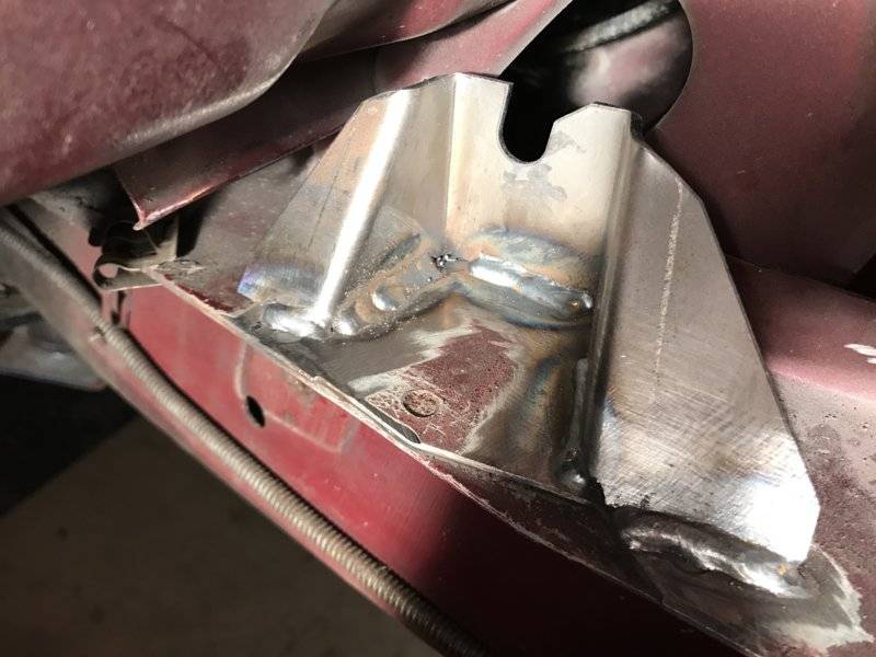

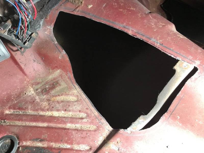

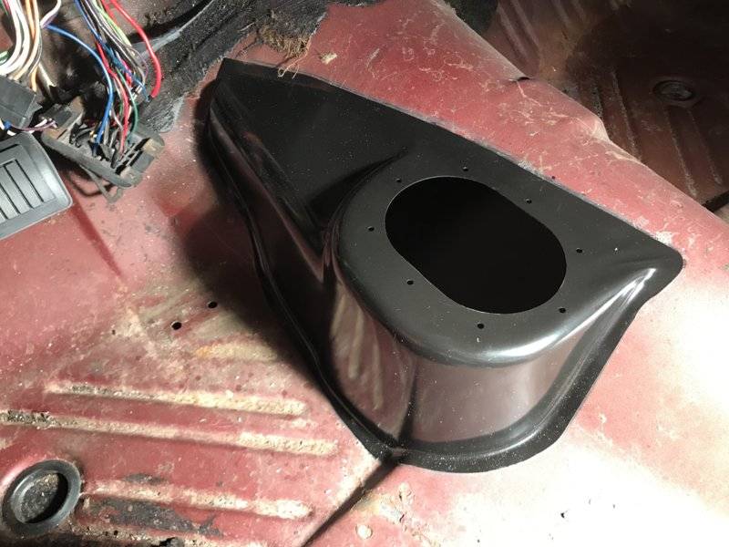

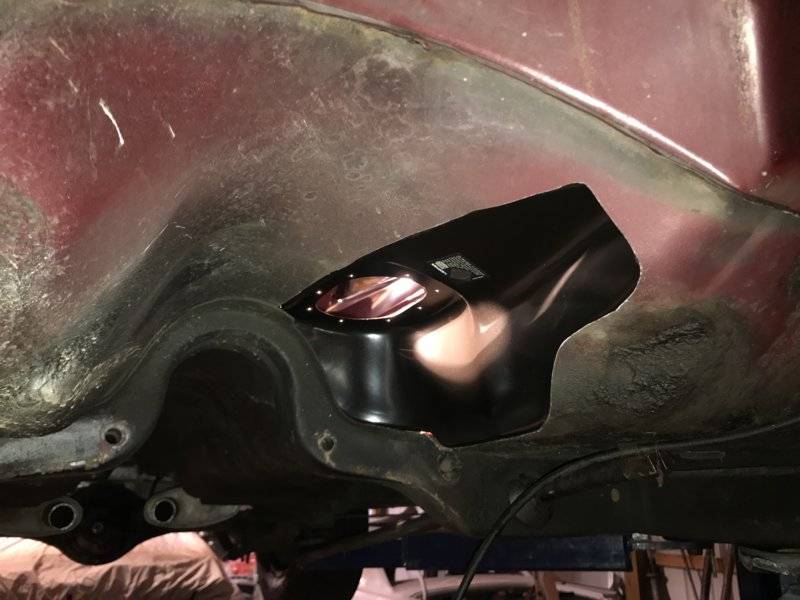

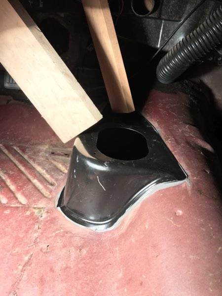

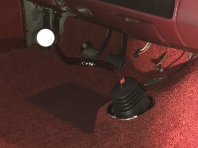

I epoxied my hump in as there is no structural component to it (probably just as strong as welding it anyhow)

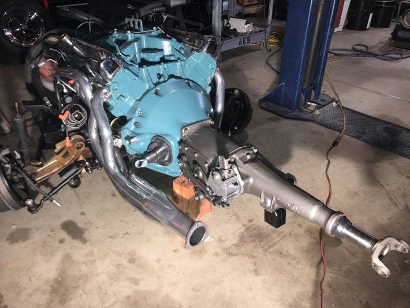

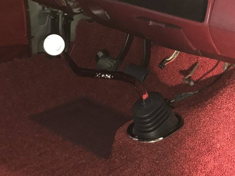

Here’s a couple pics. Let me know if you get hung up and want specific pics.
