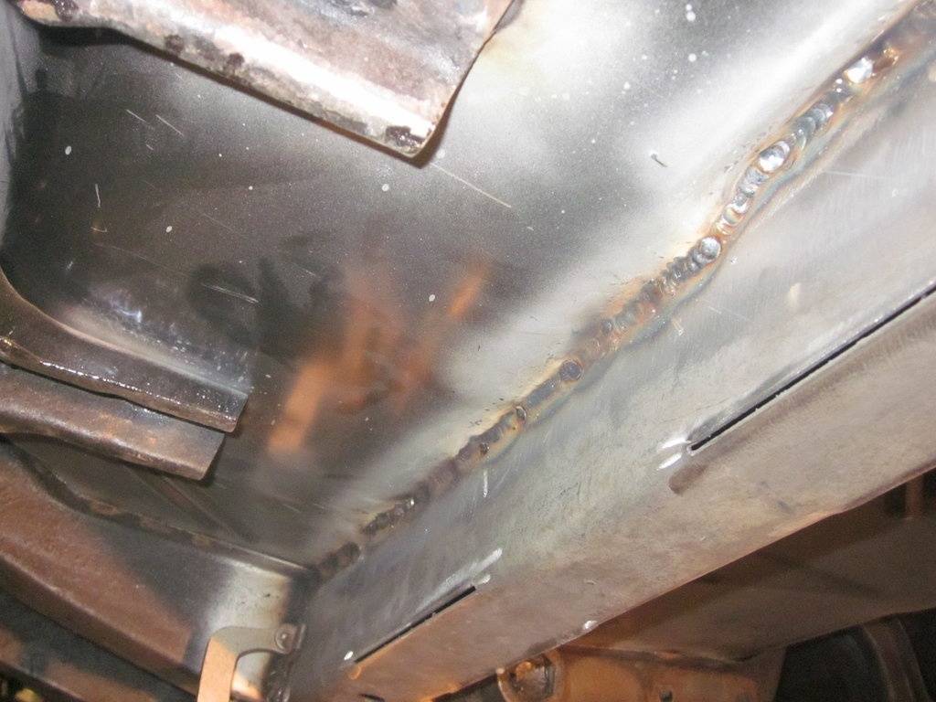

The US Car Tool frame connectors are welded in and look like they are factory. They help prevent rattles, I found one rattle where you could put your hand down the door jamb and feel the gap changing while driving. Frame connectors did correct that rattle, I now use them wherever I can on Unibody cars.
USCartool connectors transformed the 69 Coronet. Eliminated rattles as stated above. When the 440 was warmed up, the windshield cracked all the way across the first time I romped on it. Should have put the connectors in before motor upgrades. Do it. To the untrained eye, they look factory. The trailer queen crowd can leave them off.
Just my opinion. The frame connectors do make a difference. Mine are 2x3 welded into the floor pan, '70's drag style. Last week had the car on jack stands, then looked at the drivers side front, not touching the jack stand. The car is so rigid that it won't flex at all. Put the frame connectors in & be happy.
BTW, from the pictures I've seen the US Car Tool frame connectors look fantastic.
