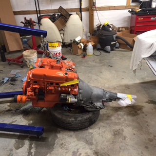

When install engine/tranny was almost vertical oil started coming from rear main seal. I had 5 qts of oil in it. Could being at almost vertical angle cause oil to go past seal?

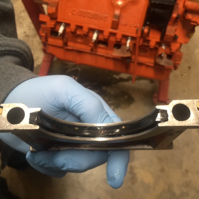

IMG_1023.JPGProblem found. The rear seal was installed backwards in the lower seal retainer. The seal in the block was installed right.

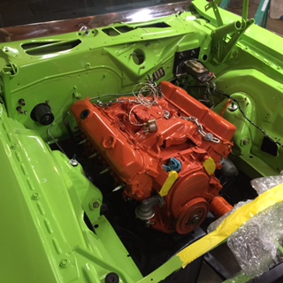

put her in
