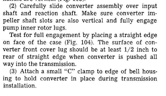

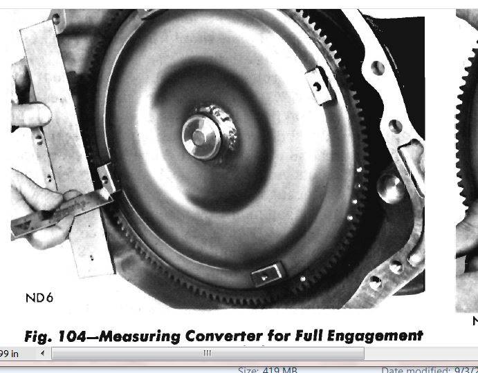

Nigel note test for proper torque convertor engagement. If torque convertor should be 1/4" to 3/8" away from flexplate. If flexplate is to close without spacers between block and trans bellhousing there are only a few things that could be wrong. One flexplate on backward or two wrong flexplate or three flexplate is bent. Go to this website and download a service manual Service Manuals – MyMopar

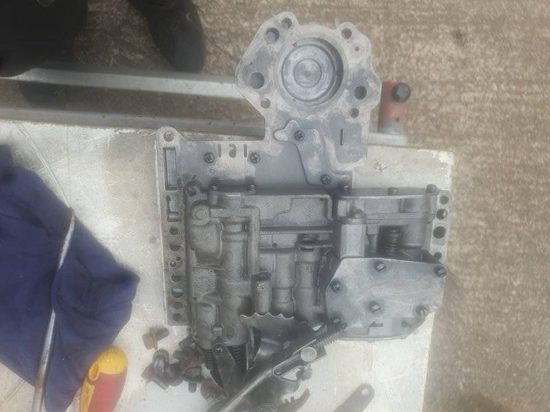

I never removed the outer race of the sprag. I was going to get a bolt in sprag if I removed the stock one. I have a VB here now I just got off my buddy. Took it out of a trans he has had sitting for years and he bought it off a guy that also had it sitting for years. I removed the VB from his trans and straight away I noticed it has the restriction plug in the front clutch orifice so it's looking like this VB also has a transgo kit installed
Nigel note test for proper torque convertor engagement. If torque convertor should be 1/4" to 3/8" away from flexplate. If flexplate is to close without spacers between block and trans bellhousing there are only a few things that could be wrong. One flexplate on backward or two wrong flexplate or three flexplate is bent. Go to this website and download a service manual Service Manuals – MyMoparView attachment 1523263View attachment 1523262
I did that procedure and it showed that there was only half the required clearance. The spacer between the block and bellhousing brought it to the correct spacing. I never heard of putting a spacer between a block and bellhousing until I saw my friends car that was built in the UK by a mopat specialist. Its Monday morning and I've a full day's work to do but I'm going to swap the VB later to see if that does anything. If that fails I'll pull the trans and change the flexplate and torque converter. I'll open the trans to check and make sure there is no damage done before I reinstall it. Ill check the sprag to make sure nothing has gone wrong with it. If it still fails after that then I'll be fresh out of ideas

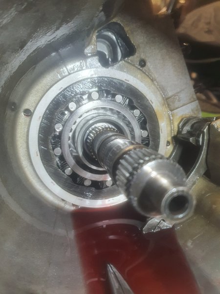

So I just got the trans apart and I look at the sprag and nothing. It looks and functions perfectly. I checked everything as I was coming along through the transmission and everything looks fine. I cannot see where the metal came from. I'm even more confused now. I was expecting to see the sprag torn up into pieces and the rollers falling around the place
did you take the pump apart?
