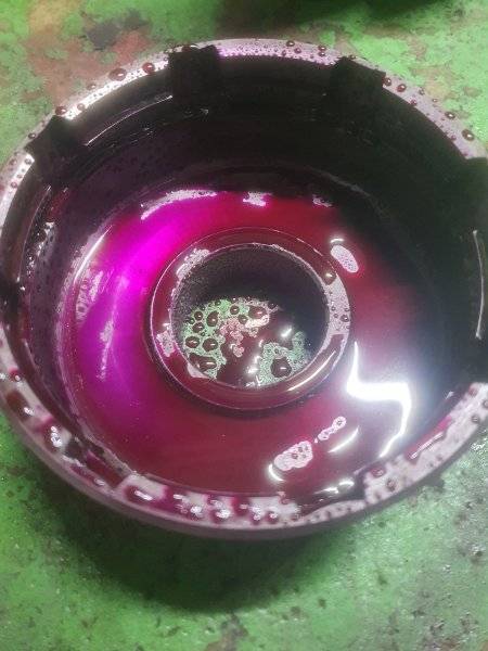

So I was looking through all the bits and I noticed a line in this. I'm a welder for my sins so I happen to have a dye kit at hand. Going to check it out and see if I'm right. I tried to rotate the sprag backwards and it wouldn't budge. I removed the springs and rollers but all the tabs are standing perfectly upright. I also drilled an oiling hole for the sprag before I assembled the trans as directed by John Cope
I'm too scared to drill that hole... if i mess up it will suck finding another pushbutton case :)

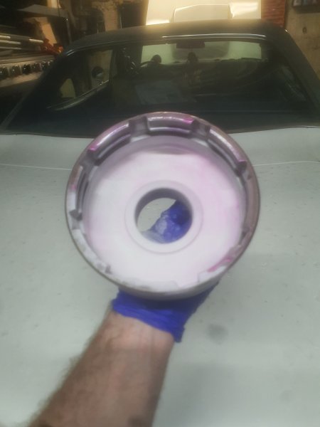

So the dye test didn't show up anything. Now I really don't know what to do. I know push button cases are rare but here in ireland if I was to find anything for my car I'm screwed

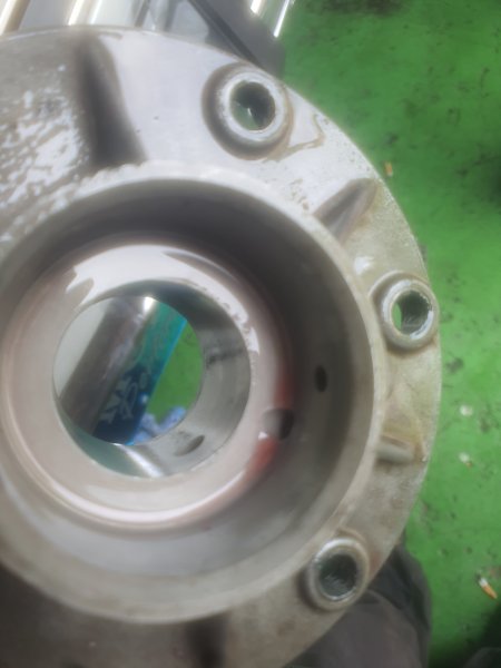

This transmission was gone through before by someone at some stage and I'm unsure if they had any knowledge on transmissions. What I am seeing online is the rear support housing can contain a needle bearing but mine has none. Is this something that is common on the 727 trans? I should also mention this trans is a 3160 so it's dated for March 1970
