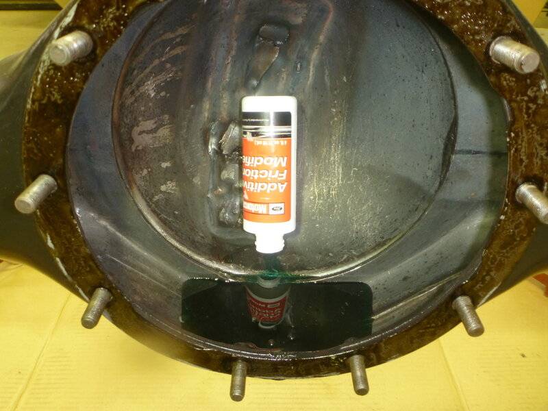

Doesnt that stuff stink like nothing else on this earth??
You can smell it coming in the mail three depots away....
...best way to put it in !
Won't the bottle get chewed up? :rolleyes:
