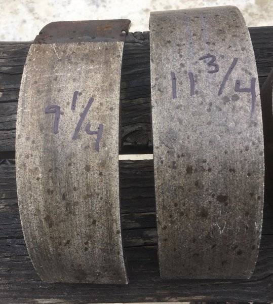

I did a light skim on rockauto, found a decent pic of a proper shoe. The one on the right is the primary shoe. These HD ones are bonded, riveted, and arc ground.
These happen to be rears which is inconsequential.
