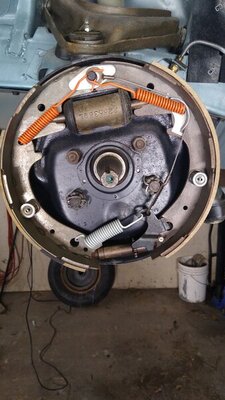

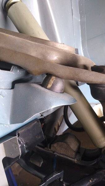

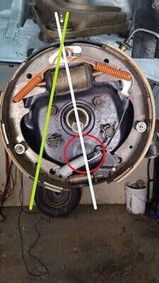

The red circle is the indentation in the backing plate for the lower ball joint clearance. The white line is the current "caster" and the green line is roughly where it should be.
Sure, the struts aren't tight BUT they're not going to pull the LCA that much further forward. I'm leaning towards the incorrect struts altogether.

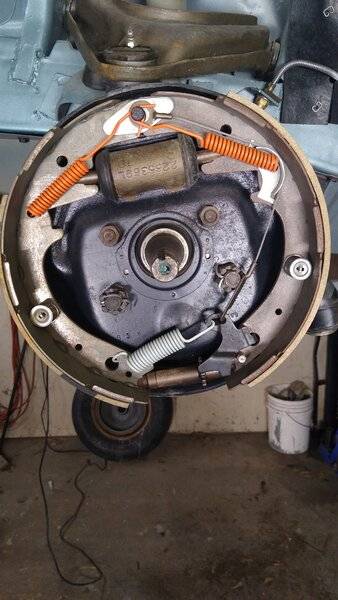

Is it just me, or does the 1st photo in post #1 and the photo in post #35 look like the backing plate is in the same 'slanted' orientation (position)...just opposite sides of the car? If so...and post #35 is of an operating car, then there is no real problem.
Well it is a real problem because the bulge indicates where the ball joint is sitting and in the first photo its clearly too far back.

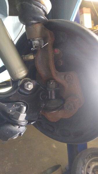

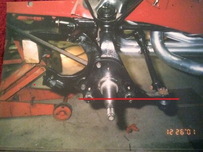

So in this photo the green lines represent where the LBJ bolts are - the front bolt not being visible. Here's what baffles me ... I've never seen a LBJ with such a steep downward angle to the tie rod end.

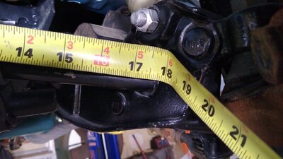

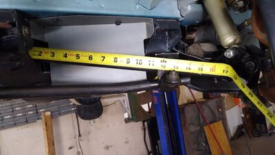

Measured from Front of LCA to the end of threads after it goes through K-member 21". Don't know how much goes into and through LCA. Now didn't get on the floor, used cam adjustment hole to position tape measure. The fat man only gets on the floor to work on my car.:eek::D

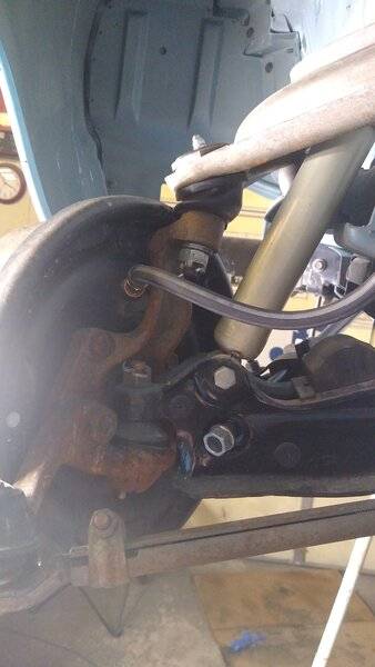

After tightening everything up. It looks the same. I measured the strut from the k frame (around the bushing and washer ) to where it goes thru the control arm. Maybe it can be straightened with a alignment?
Also ran a string line from ball joint to ball joint. Control arm run pretty straight with the line

What is that nut and bolt at the 13" mark on tape measure? See that in pot #14 on right hand picture. Is there a sway bar on the car? From above can you get a picture so we can look at how it looks in K member? Something is really wrong, more photos but not all close need to get a better perspective. The red arrow in picture is my strut rod end, does yours look like that?
View attachment 1230358 What is that nut and bolt at the 13" mark on tape measure? See that in pot #14 on right hand picture. Is there a sway bar on the car? From above can you get a picture so we can look at how it looks in K member? Something is really wrong, more photos but not all close need to get a better perspective. The red arrow in picture is my strut rod end, does yours look like that?
Looks the same. The bolt you see is the sway bar
After looking at the pic again, I think you may have nailed it. :thumbsup:
Thanks but don't think so, I thought it was passengers side. It's the drivers side, the upper A arm has an area for rubber bumper to hit. OP needs to pictures of one side that shows a larger area for a better perspective.
