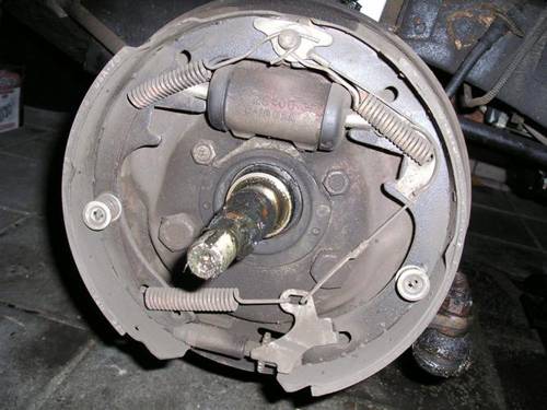

My 65 Coronet when doing disc swap.
It's almost like the backing plate bolts are drilled at the wrong degree. The upper and lower ball joints are close to being In line. I'll tighten up struts tomorrow and see if anything changes
I'm wondering if they are the correct backing plates. It might have been a 10" to 11" swap at one time. Could the backing plates go on either side and be on the wrong side?
Also I've seen the A and E bodies with the backing plate nuts on the inside but I thought B bodies had the nuts on the back side of the spindles?

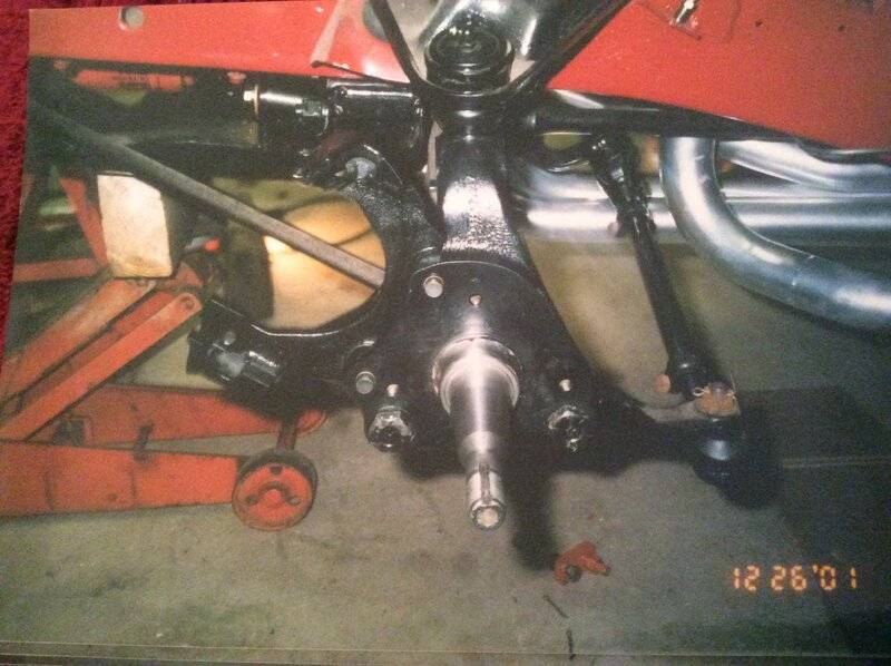

the lower ball joint in post#14 it's not bolted to the lower control arm.
Heck guys it looks to me that the lower ball joint isn’t in the lower control arm socket spindle is hanging from the upper A arm. Oh wait I see from the other side it looks to be in the socket I must be blind!
The shiny black makes in look that way.MO

If the upper c/a's and spindles are correct then the lower control arms/strut rods cannot be fully installed.
