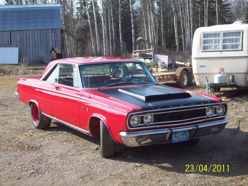

why are your front tires wider than your back tires you wrote front size 275 60 15 on 15x6 wheels and rear 255 60 15 on 15x8 wheels you must of wrote down the wrong sizes i assume, hows the idler arm on that ol dodge i didnt see any mention of it but those always get worn out and make things sloppy if you didnt replace it i would recommend it , now how about showing us some pics of that nice looking 65 of yours.

Here she is when I finished her up in June.

All the suspension is new. Idler arms, bushings, pitman etc. Only thing reused was steering box as it seemed okay. I have bought the offset bushings, I think I will put them in and have it re aligned with the positive caster.
