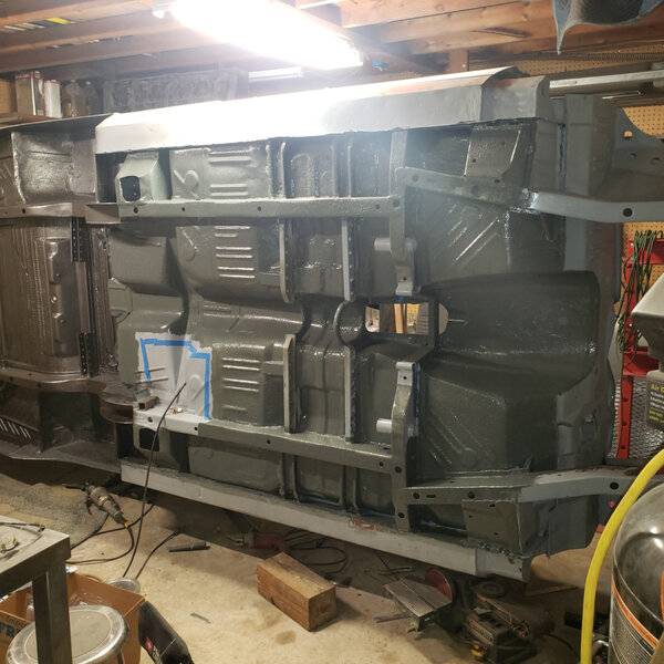

Why would you not cut the floor and weld the entire seam? Granted its a little more work.
Doug
Doug
Not making a 600 fold blade here just a car frame.If you flush the 2x3 stock to under side of pan and flange the sides of 2x3 stock you extend the spot welded surface and layer the material ten times more strength by spot welding un cut floor pan to the 2x3 stock.
Great answer full welds that the factory doesn't do much you would be a good one to ask have you welded a K in?I weld all of mine to the floor, to me it makes for a far more solid/strong. I know that with my Cuda which has a USCT SFCs on it they are as solid as any part of the factory frame.
Doesn't make sense what your sayingNot making a 600 fold blade here just a car frame.

Bean are you sayin dont weld?
Thank you Sir for an awsome answer welded frame is better.I can tell you that the rails welded into my split floor pan flat out work. My car has stock rear rails. Leaves square and level right to left. It has over 750 passes on it. 60 FTs in in the mid 1.2x range off the foot brake. The body is still laser straight. What else could you ask for?

Think what is a frame for?So my best friend brought to my attention that the U.S. Car Tools subframe connectors require welding to the floorpans (which I knew, but wasn't thinking about). Before I began to see my car in the reference of trying to make less "invasive" performance modifications, I was all set to use the U.S. Car Tools frame connectors....
My Assassin traction bars are shipping next week, and I'm ordering my Calvert split mono leaf springs and sliders as well. So while the car is having the front and rear suspension system replaced, I may as well tie the front and rear frames together.
What brand of subframe connectors do the best job without having to weld them to the floorpans, and how drastic of a compromise is that vs the U.S. Car Tools pieces and technique?
Thanks to all of you. I want to make the order by next week, so please let me know what you think!
