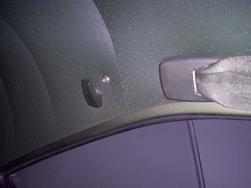

These? Sorry, misunderstood, these are seat.

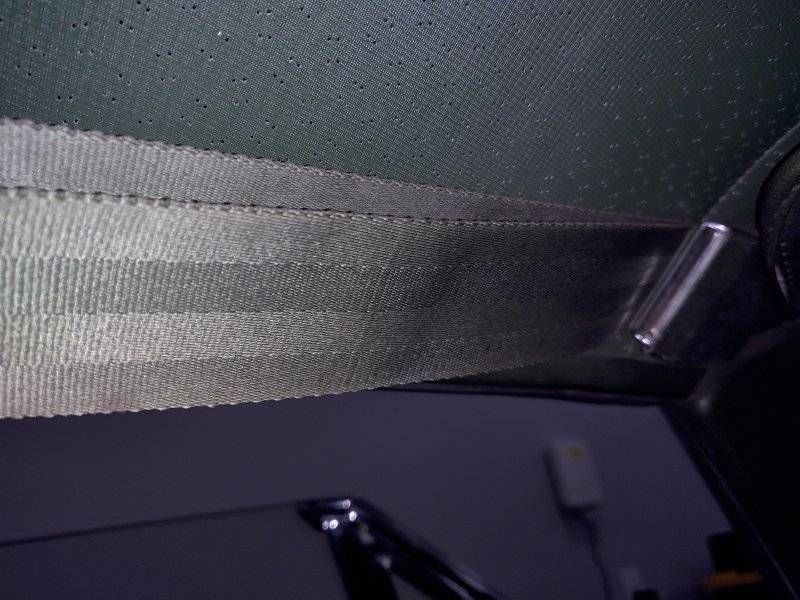

Olivier, the receiver end of the shoulder belt is stored along the headliner, near the sun visor, with the hardware pictured by Mopar Hunter. The roof belt should look like this:
The last picture you posted shows the "male" end of the belt, and it's usually found on the front seats, not the roof, as far as I know.
I only know, through cars I've owned, that it was for sure found on '69 and '70 B-Bodies. I just did a search and found that '68s also had this set up. The pictures I posted apparently are for '68/'69 B-Bodies (with the receiver at the sun visor). Your picture shows the male piece, which I believe, but I'm not positive, shows a '70 (and up?) set-up, where the buckle/receiver/female end was located on the seat.

And one more thing: you'll need these storage clips, two on each side: Mopar OEM 71 72 73 74 A B E body roof mounted seat belt clip Set Black | eBay
