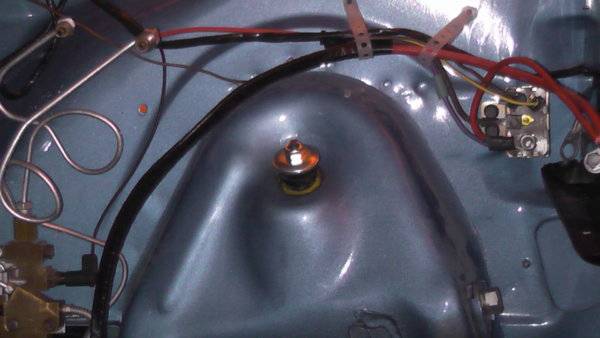

Just installed 1 shock and should there be a washer under the rubber bushing,or what you see right.Have not tighten it up as yet.What ya think.
Aren’t the bushings cupped on one side to sit in the sheet metal? I believe no washer against the metal

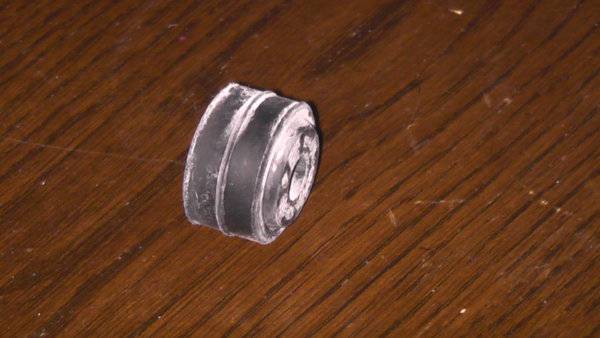

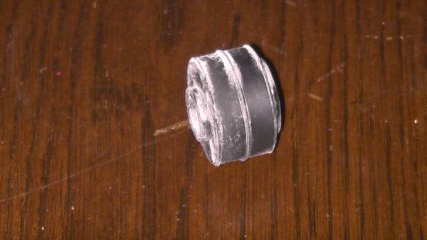

This is what i got ,its bean a long time having the B BODY.I HAVE had many A body cars.
Should be 2 washers and 2 bushings, like I said the cupped end of the bushing sits in the shock tower, washers sandwiching the bushings.
Yep, the small part of the bushing goes to the sheet metal and the big part of the bushing goes to the washer.
