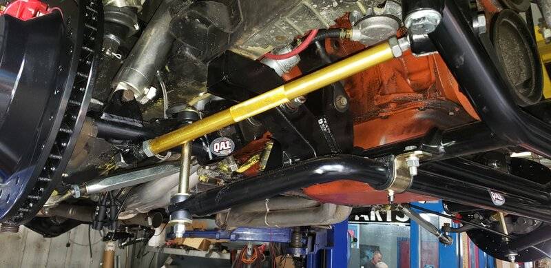

These components are EXACTLY what I installed in my 70 Roadrunner. I moved the 2 way adjustable Viking Warrior shocks to the new suspension.

View attachment 1100111 View attachment 1100112
I run the exact same on the rear if my Challenger. I run a tubular K Frame and a rack up front for the flat bottom top fuel/funny car oil pan for plenty of ground clearance on the street and room for big tube headers.
I think eventually I'm going to want to do the "front sway bar flip" on the QA1 K-member and suspension.
It looks "funny" hanging that low.

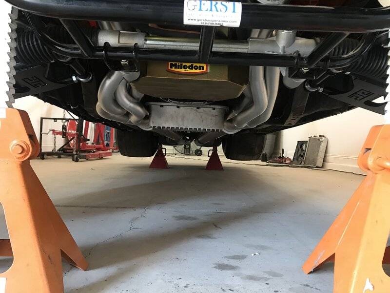

I went with GERST. Definitely the “Easy Button.” Milidon pan with integrated pick up left plenty of ground clearance.
817CD112-6F7C-4CB8-9F5A-768E8CEDF8F1.jpeg 8F09E86E-21FC-4312-9B6D-66CC669BF094.jpeg
My flat bottom oil pan hangs as low as my trans pan. Headers are the lowest points.
