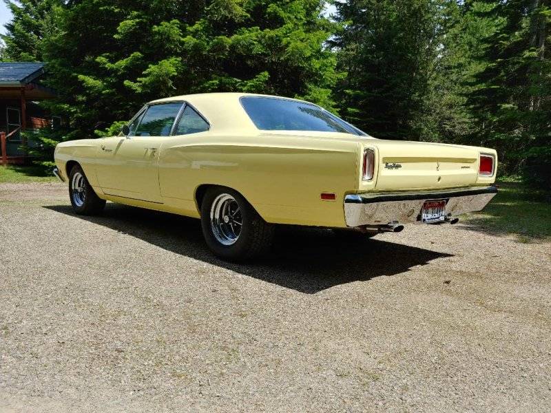

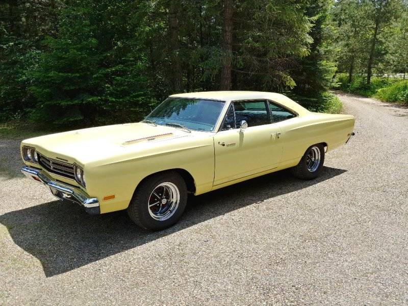

This is what the 245s on 15x8s look like; can hardly tell the difference between 235 & 245 sizes. (275s on rear.)
