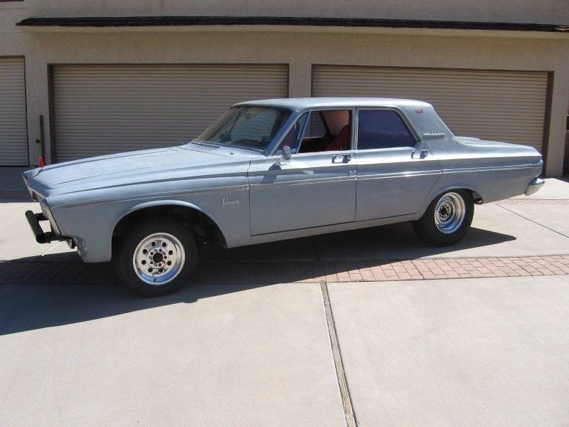

I had them on my 63 first as shown in this photo. Not the best photo and they may look small but I had the torsion bars cranked up for the 60's vibe. Too stiff so I went with the taller 27'' and let the bars down for a better ride.
