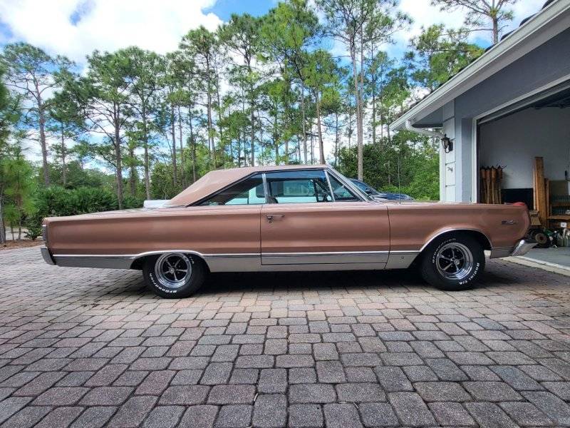

I had mine too low for a bit - don't know the measurement but I could feel it hitting the bump stops in the steering, particularly when I would go on/off bridge transitions on the highway at speed. Car didn't feel stable for a moment.
Ended up putting in new torsion bars and springs - 1.03 bars and +1" springs to give it a slight rake front-to-back . Set the front end to spec and it drives much better now. It did raise the overall ride height of the car which is not what you’re after but mine was too low before and would drag the exhaust going over sharp angle changes like going in/out of the Daytona race track for car shows.
