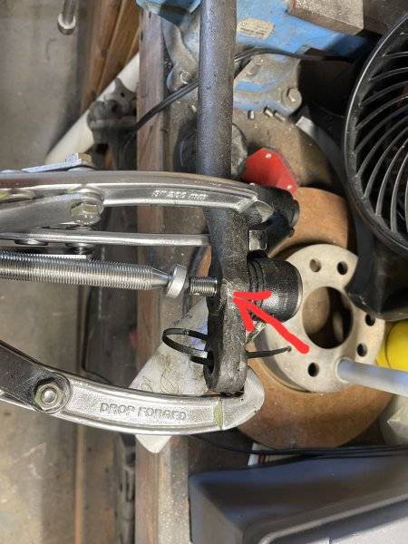

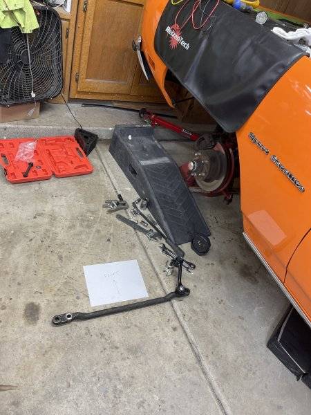

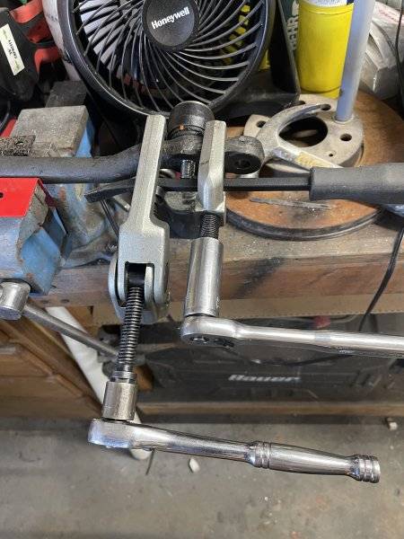

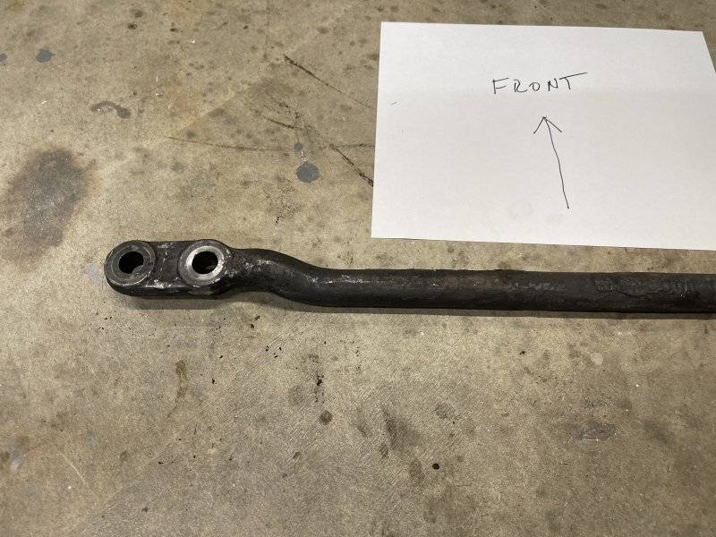

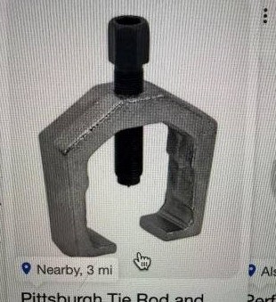

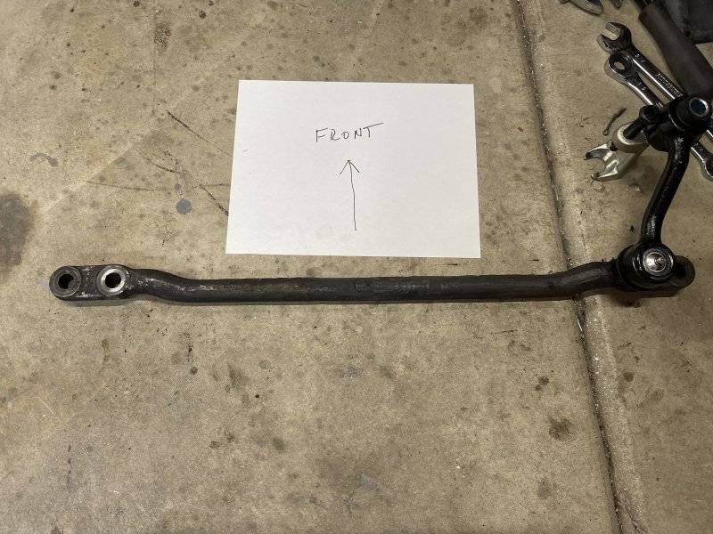

The outer tie rods need to come off first. Taking the pitman and idler off first leaves the center link too flexible and it often bounces when you're trying to smack on it. It helps to use a gear puller rather than a pickle fork but it looks like the way your headers are routed, that may not leave enough room.
If I had your car, I would steer hard left or right to get the pitman end out of the way of the headers.
