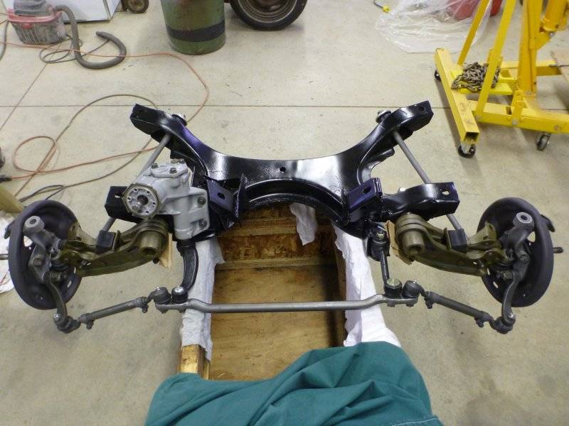

Not sure how you'd ever install it upside down, but turned 180 degrees would be a possiblity...
Here is correct...
Thanks Wayne. So the center link is not symmetrical? Looks like mine is oriented similarly to your picture but I am not sure.
Yours is not the same as Wayne's. Yours looks to be curved towards the oil pan where it should be away from the pan. Usually the ones on wrong will also be very close to the oil pans drain plug.
So do you think mine is “wrong” because its 180 out or upside down?

Take the end of the center link that is on the driver's side, and put it on the passenger side, while keeping the top side up.
Thanks that’s the most explicit explanation of what exactly I need to do. I appreciate it.

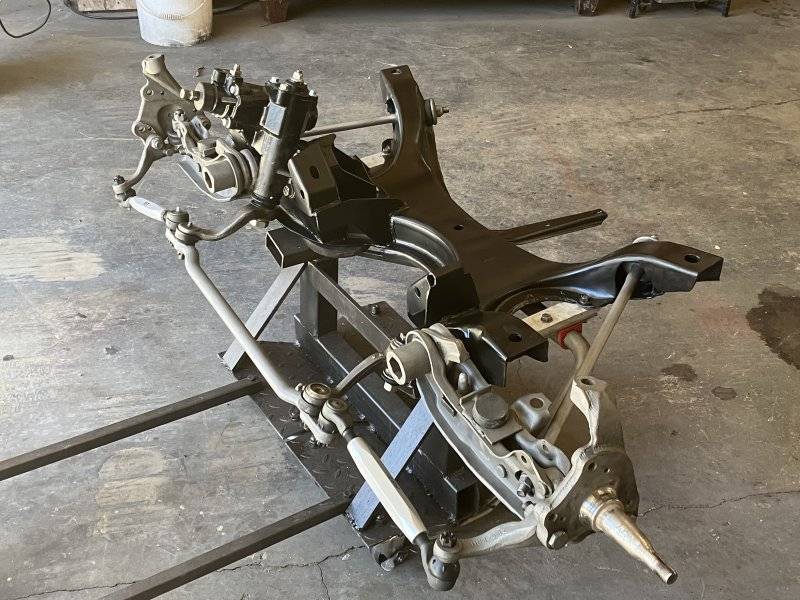

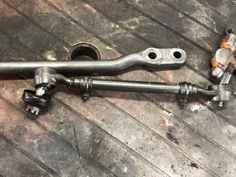

ALL B bodies had a downward dip in center link that also aimed to the rear of the vehicle, never the front.
My '70 Charger suspension design is identical to your '70 Plymouth.
You may need to bump the tires a bit to steer them one direction or the other to get the tie rod ends to line up and fit into the center link but that shouldn't be too hard to do. Make sure the parking brake is engaged!
Thank you KD. I see what you are referring to the center link end pointing to the rear. Looks like mine is pointing to the front. Thanks for the tips!
