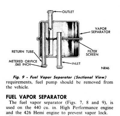

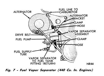

Did you also regulate the pressure before the carb? Glad this fixed your issueLike you, I had shocking fuel boiling issues. I tried carb insulators/spacers and insulating the fuel lines all to no avail. I also was sick of dry fuel bowls and hammering my poor starter.

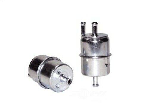

I installed a Carter electric pump just in front of fuel tank and installed a Wix 33040 (or 33041, not sure) and ran a 1/4" return line through a bulkhead fitting I added to fuel sender. Now car starts instantly as elec pump fills my bowls before I crank and fuel has never boiled even in 100 deg + weather.
Note - the return nipple on filter must be positioned to be at the highest point to work effectively. -
