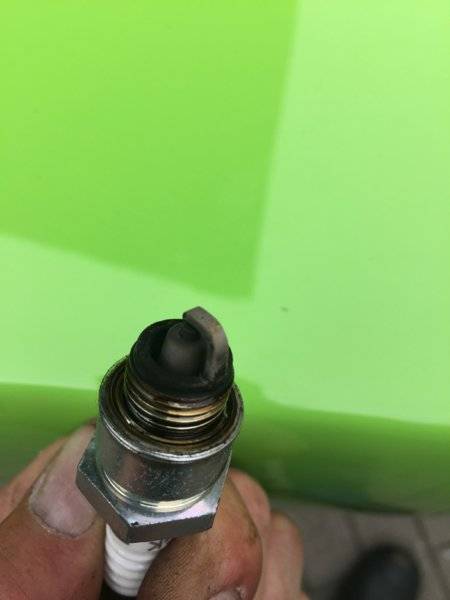

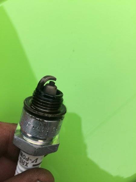

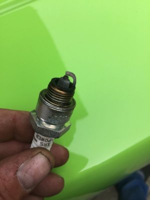

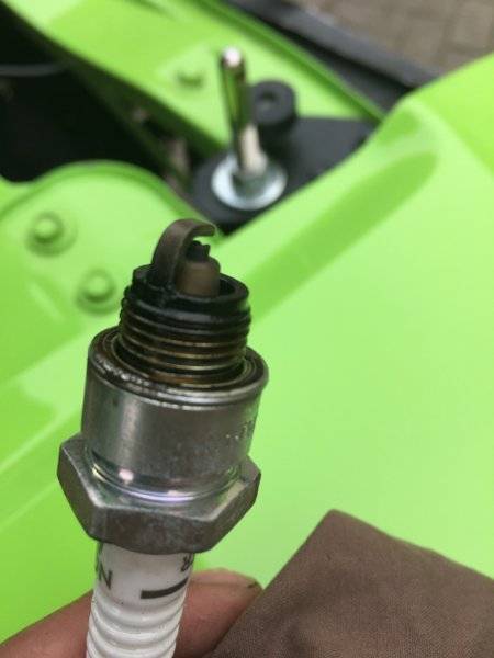

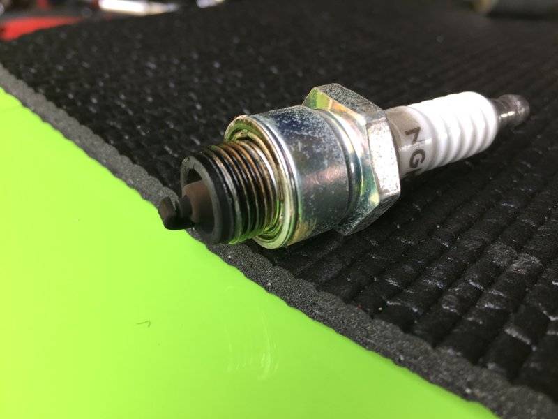

I have pulled all plugs on the passenger side bank.
There are some differences in appearance, which might be caused by the intake manifold difference??
I have an Edelbrock Performer RPM manifold.
Some look very rich, some appear clean with some signs that the ignition timing setting is ok.
Pictures off all 4 cylinders plugs on passenger side bank.
8 6
4 2

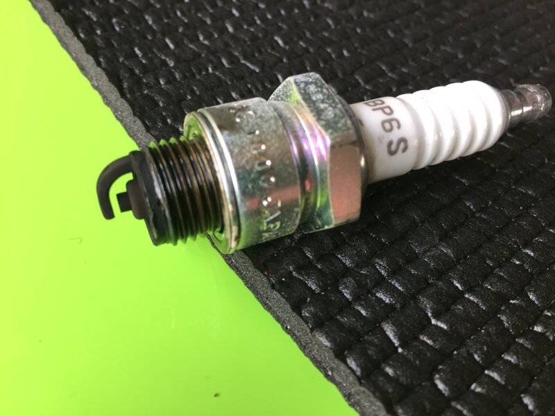

Last weekend i took it out for a weekend break and have driven it around 200 miles, mostly at 60-70 mph.
When i returned home i pulled some plugs and found them black with soot, but at least they were found dry.
I think it has done some good driving some longer distance with higher speeds and probably cleaned up quite some deposits from the internals.
