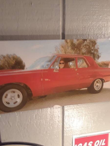

I know this thread is old so I don't know if you'll even see it, but I just could'nt resist' I thought I was the only nut job who was looking to max a 440 B-body for mileage although in my case I am looking for max mileage as a goal from the start of the build. Also dropped comp ratio to 8.2:1 to burn 87 pump. (really curious about the fun of driving a wimpy 440, we'll see) Just like the challenge and would like to drive it as a second family vehicle rather than just to car meets. Also a plus when you have been on a fixed income for 25 yrs as I cringe at the thought of paying for premium gas. Have built a number of hot rods in my day but the gas prices back then was a moot point (hence Old Guys Rule). Ready for official old fartdom now as I hit 66 a few days ago and have little choice in the matter. The cam in this one is pretty much a passenger type as far as duration is concerned but with a modern profile. Extra lift plus 1.6:1 rockers with a 112 degree LCA is as wild as I went here. Edelbrock intake, modified holly 750 carb, dual exhaust with magnum manifolds, manual 4 speed O.D. tranny ( .71:1 4th) and 3.23:1 gears and 27" tires puts the motor at 2000 rpm ( now it's torque peak) at 70 mph. This gives a final gear ratio of 2.29:1. Am very curious as to mileage it will give, anyone care to prognosticate? I stopped when I was 15 when I met my now wife of 50 yrs. LOL! Planning to drive it from Jacksonville FL to Amarillo TX to see an old high school auto shop buddy and take a good measure of the highway mileage. I know, long boring post but max mileage is a universal madness with old age (bragging rights), so little left to brag about at this point in life. That's all for now ( enough already!). Will keep you posted, I know it's what you live for! Super Dave

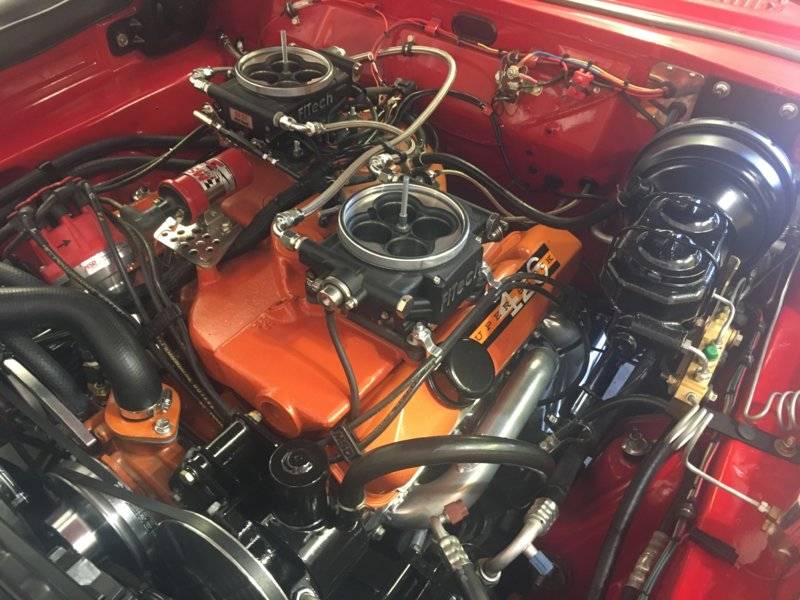

Wietse; Go to the Summit site for the EFI unit you are looking at. Download the installation instructions to get an idea of what's involved. When I switched over to EFI I originally used a FiTech engine compartment mounted supply canister with a high pressure pump. Unfortunately, it was early in their production and I had problems. I then rode in a friends car that used a frame mounted electric fuel pump mounted back by the stock tank. I decided I couldn't live with the pump noise as I drive my car almost every day. My next move was to buy a custom tank with an intank pump, which is what is in the car now. In my estimation, it's the best , although the most expensive, solution.
I have been using EFI for over 2 years now, and, although I tuned carbureted race cars, race boats and street cars, and offered carb rebuild services for a speed shop for many years, I will never go back to them. The benefits of EFI are many, including fast cold/hot starting, instant drive away, self learning to parameters you can set, and similar mileage to a well tuned carburetor. BTW, having that little hand held device, and being able to alter the A/F ratio on the fly, as well as the timing, is icing on the cake...
I have been using EFI for over 2 years now, and, although I tuned carbureted race cars, race boats and street cars, and offered carb rebuild services for a speed shop for many years, I will never go back to them. The benefits of EFI are many, including fast cold/hot starting, instant drive away, self learning to parameters you can set, and similar mileage to a well tuned carburetor. BTW, having that little hand held device, and being able to alter the A/F ratio on the fly, as well as the timing, is icing on the cake...View attachment 715518

Quiet pumps exist for low pressure applications (carburetors) but not for EFI where the pressure is much higher. Mine requires 58 psi minimum...

If the pick-up is 3/8" I would use it. I would recommend you insulate the pump mounts with some rubber padding to try and keep the noise down. Good luck...and thanks for the compliment.
