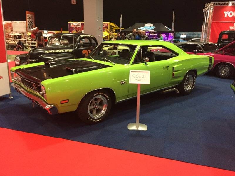

Hello gents,
This weekend i was at a racing expo nearby where i live, the shop i bought the car from asked me if i would like to show my car there on his stand...which i really liked! (picture :) )
