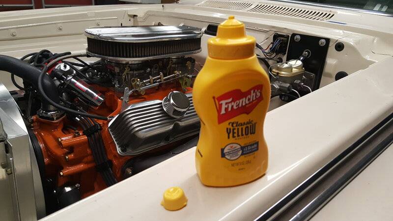

Prime the carb with a catsup squirt bottle and fuel through the vent on top of carb. You might have to repeat a few times but it will be easier on the starter.
I recommend you remove the catsup and rinse the bottle before you put the fuel in, just say'in... :lol:
Here's what Wagonmans talking about. I prefer mustard. Never was too much on ketchup :)
I use a plastic olive oil bottle. I give each vent a good 1/4 of the bottle squirt and she usually fires on the first crank after a long winters sleep.

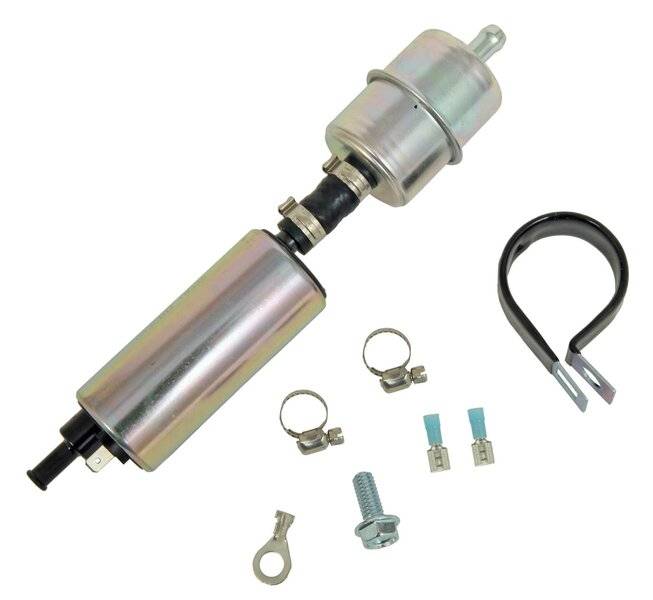

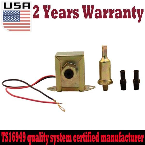

If you have fuel evaporation issues, a inline pump and a momentary pushbutton switch works great to prime the carb.

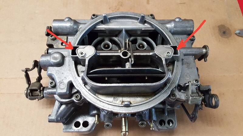

Since the answers have degenerated -- look at that carburetor. Doesn't it look like a face?
