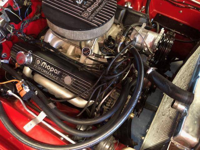

Adding A/C and heater hoses really makes this area cramped. I really would like to find a Y type fitting and then make my own lines to the carburetor. I looked at the Summit Racing site and I did find a couple but I also need a port for the fuel pressure gauge. After looking at 20 pages, I gave up. I do have a Speed Shop in Sacramento that I may check with tomorrow. Ideally, I'd place the Y in between the fuel bowls so I'd have room for a filter between the distributor and the Y.
I suppose that I could put the filter down near the regulator but I like seeing fuel in the filter. At rest, the gauge reads zero but the filter lets me know I have fuel in the line.

Hey kern dog, I went to jegs web site and found a hand full of side outlet fittings for mounting a fuel gauge that you could put inline. Maybe put fitting in one side of y block, mount gauge, run lines to carb, cut in filter, presto-chango your all done. Well, maybe not that easy. But there are a lot of fitting options on jegs site. I hope it all works out for you!
Thanks guys...I figured out a way.
Someone mentioned putting the filter near the pump. I did something similar. The regulator is frame mounted so I used a 2 inch hose, the fuel filter, another 2 inch hose, then the solid line bent to snake across the alternator, around the distributor and up to the existing dual feed line. I used aluminum tubing....I have steel lines here but the aluminum is so much easier to form the shape!
Are there any drawbacks to using aluminum fuel line?

Only thing I see, Kern Dog, with it routed at the outside of the alternator, it's mighty close to the exhaust manifold. But, that's your call.
Can't say on the aluminum tubing. Steel is real easy to shape, with the proper bender.
