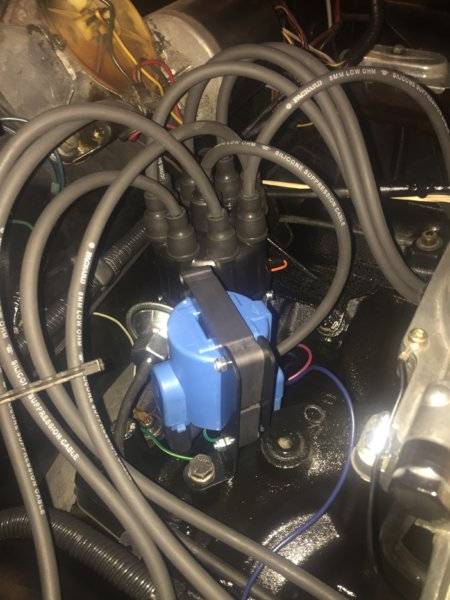

For the HEI system, I used a new OEM-style vac advance electronic dist. from R. Ehrenberg, he states it has a performance curve. I have the LX-301 ignition module mounted under distributor on the designed2drive plate, and I am using a standard ignition E-core coil. Ballast is bypassed. All the wiring is solder connections, heat shrinked. The ignition module is grounded to the block. My work is very clean, I am a former helicopter mechanic so I obsess over details. I checked continuity on all connections, all looks good. The cap is brass terminals, the wires are new 8mm and plugs look good and are gapped to 0.045". I double and triple-checked plug firing order.

I also noticed that the timing light would cut out randomly while the engine was backfiring/sputtering - AHA! Apparently the problem is ignition related. New standard ignition products (not the cheapo "T" parts but the blue flame ones) coil and module. Rick E. Electronic distributor. So something is not working right.
The coil is an E-core, solid state and seems really unlikely that it is 'bad'. A resistance check between terminals showed .04 ohms and it doesn't appear damaged in any way. It was only warm to the touch while running.
Same thing with the ign module. Brand new, mounted to a heat sink with thermal paste, wasn't even hot. Good grounds everywhere, from module to block and from coil frame to block.
There is something a little concerning with the distributor, the reluctor pickup with the 8 contact points is poorly manufactured, and the gaps are different between all 8 points. I don't know if this could be causing the issue. Seems like the poor running would be persistent throughout the rev range if so.
I'm in the process of putting my factory points back on (done actually, just have to scrounge up a male-male ignition coil wire) to triple-check that the ignition system was indeed the cause of this problem.

Well crap. Been cruising FABO and it looks like i may have made a serious mistake buying this distributor. Apparently the "340 timing curve" it is advertised as having is not even close. I should have done my homework, I really don't know much about timing and trusted the ad.
https://www.forabodiesonly.com/mopa...istributors-from-rick-ehrenberg.386164/page-1
I'm not 100% sure the distributor is the issue, but everything else has checked out...
Not saying that your distributor is the issue, but I will say that not all of the stuff Ehrenburg sells is the best out there. He's kind of a dick imo. All about $ and making sure in his mind he is better than the rest of us.
