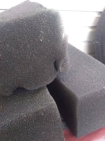

I finally installed a fuel pressure gauge I've had on the shelf for 20 years, and the pressure is good at 6 psi until I floor it then drops to under 3.
I disconnected the fuel line to change the Mallory filter, and the fuel just trickled out of the line.
I have fuel cell and some bits of the foam were in the filter.
It also looks like the foam was jamming up the outlet. See pic.
I pulled the foam out and it didn't look horrible, but obviously starting to degrade.
So I'd say 25 years is pushing the limits on fuel cell safety foam.
