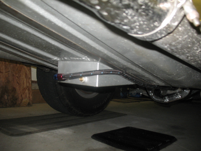

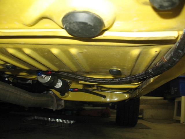

Hey Marc, I have the Fast EZ1.0 and used the original fuel supply line as the return line to the sending unit. I had the tank sumped and run an EFI rated hose to an external pump to the manifold

You're doing way better with English than we would do with Dutch. Since you're not going to need the evap tank anymore as long as the line fits the diameter requirement of the FAST unit you are in good shape. Do make sure and use FI rated hose for all connections.
Looking forward to a report on how the FAST unit works for you.
