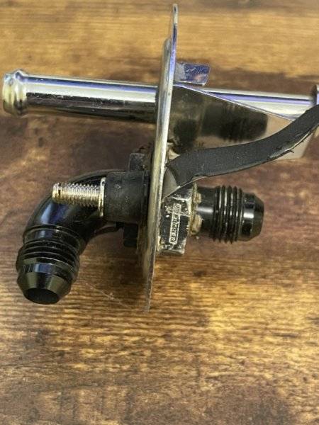

Looks like what I need. Is it correct that a line from that new nipple needs to go to bottom of tank? Something about gas bubbles from it spraying fuel from top?
I have read that it would be ideal to have it do that, to not aerate the fuel, however how you see my old sender is how it was, and didn't seem to affect it getting fuel.

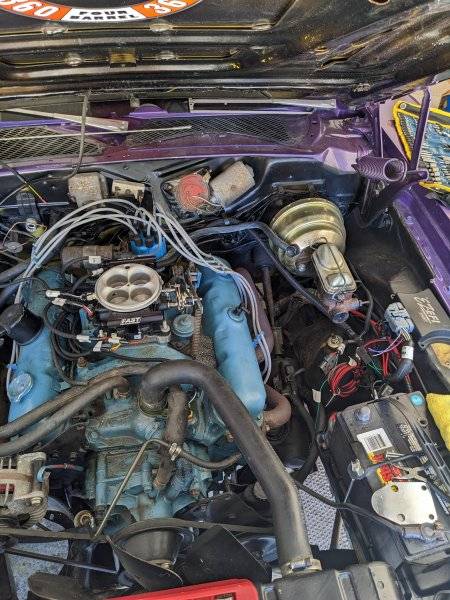

Your engine looks stock. If it ran good with a carb, it will likely run good, maybe better with the EFI.

Engine is very stock. It does have headers. It's weak won't even turn tires over but that's not a huge deal. Just wanted to have it run smoothly and start up quick. I know about max HP on this kit. Wondering if not having huge hp that the difference between return line and input line will be a big deal. Read a few posts saying it works fine with different size lines and others that say no. My regulator is mounted above vapor return line and would be ideal to hook fuel return to that. Last resort is to run 3/8 lie provided from pump to carb and buy more 3/8 to return to tank. That will consist of replacing sending unit and tapping a new hole and welding a 3/8 nipple. I really didn't want to do that.
