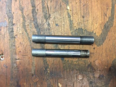

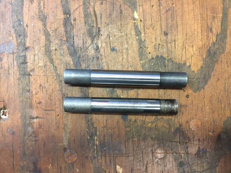

Yep. I’ll be looking at that. The lines are only a couple of years old. But I have plenty of spare FI hose. Easy to do. I’m pulling the fuel pump back out today. I was looking and a lot seem to have an issue with the rod. I am really starting to think the rod makes sense. It really seems to starve out when under load.

That’s what stumped me.. I had 6psi at the carb when cold. Zero and starved out while coming up the hill to my house. All the checks I have done have shown normal when on level ground at no load.
Hey, I went for a drive, car ran fine. Parked it for 5 minutes and I could get mine running no matter what. Found out my push rod was 3/8" shorter then a new one. What do you want after 110K miles? Good Luck
