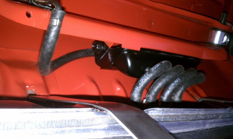

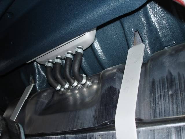

Nope, nobody makes these, I searched everywhere. If the valve inside is still free, you can hear it if you shake it lightly, it should be good to use, however, you may want recondition it before installing to get any rust out of and off of it. I soaked mine in evapo-rust for a few days, it came out very clean. After soaking it I flushed out the inside with a solvent to get all the de-rusting solution out of it, and then blew some compressed air through it, then painted it.
Here is a before and after shot of mine.
No reproductions, best bet is good used ones as mentioned. I bought one from MoparMarks a few years back, cleaned up fine.
