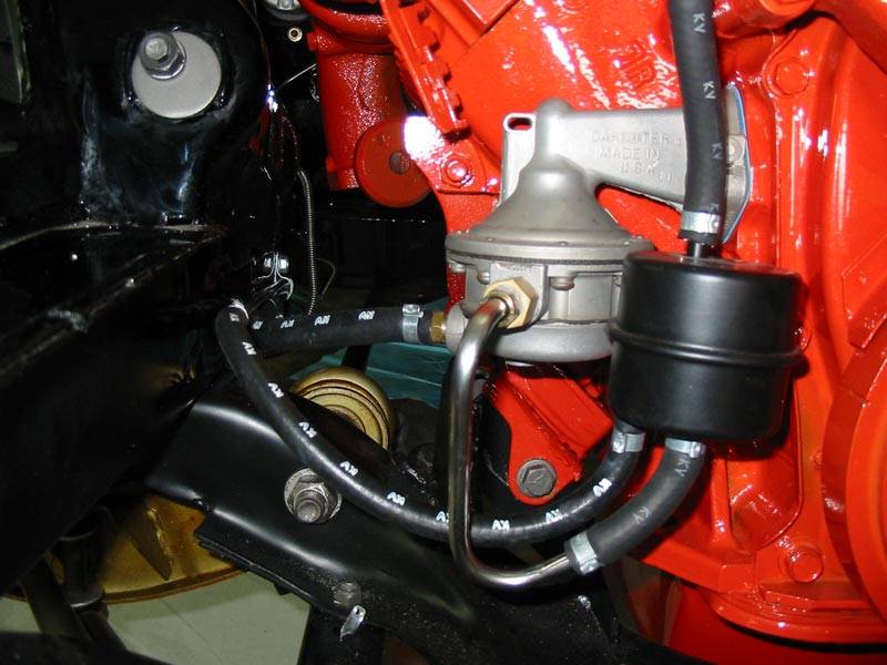

just wondering why the 440 and 426 had a special fuel filter but not the 383. Would it be a good idea to add one? If so how is it installed?
it was for high performance engines not all 440s,you dont need one for the 383. I have a 6 pack and dont have one on it.Your gas tank would have to have the extra vent line to hook it all up.

You need a 1/4" return line back to the tank. If you don't have the 3/8" pickup you will be missing the 1/4 port at the sending unit for the return. Next best thing to do is to steal one of the gas tank vents for a return and that can be bad depending on the year of the car and how well the tank vents
It is a 5/16 line running back to the sending unit. I am running a dedicated line since it will be a raw fuel return to the tank. PMJ8047, message me your address and I will send you my extra fuel vapor separator.
Sorry to disagree, but the OE return line is 1/4" on the separator, frame rail line and sending unit. 5/16" from fuel pump to separator and separator to carb line.

383 had 5/16 full line from sending unit to the fuel pump. 426/440 had 3/8 fuel line from sending unit to the pump. The vapor separator had 1/4 line to the sending unit.
If you have the nipple on your gas tank for a return line then its not a bad idea to install it with the crap gas we have today. This cheap pump gas I get in Md will boil sometimes if it gets to hot for the fuel at the carb bowls and can also cause vapor lock since it has ethanal in it. Ron
Not in every case. I had my R/T since '87 and only recently replaced the original tank, fuel, and return lines. Still had the factory clamps and undercoating on everything. Sending unit had 3/8 outlet and used 5/16 line. Not sure why it was done that way, but it now has 3/8 from the sender to the pump. I used to race it in the early 90's and never had a fuel delivery issue even with the 5/16 line.
