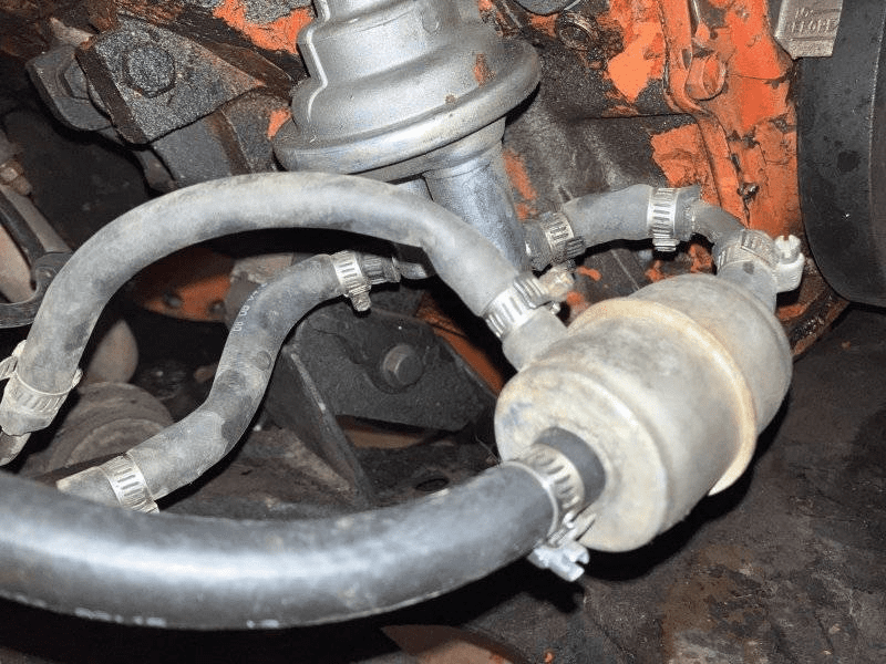

Previous owner did this to mine. Can you expand on what year cars this matters and why?Next best thing to do is to steal one of the gas tank vents for a return and that can be bad depending on the year of the car and how well the tank vents
Also used on '68 & '69.It was a fuel vapor separator that came on the 426 Hemi and 440 HP engines in 1970 and 1971.
My 69 Charger R/T had one, so they must have been around before the 70 model year.It wasn't really a filter, although it looks like one. It was a fuel vapor separator that came on the 426 Hemi and 440 HP engines in 1970 and 1971. Its purpose was to prevent vapor lock. Vapor lock is caused by several factors, and not everyone will have the issue. They would sometimes get plugged, too. It also seems likely, over the years, it was mistaken for a filter and replaced. For those who do not experience a vapor lock problem, they're happy to leave it off.
It's discussed in the Fuel Pump section of the Factory Service Manual.
This is exactly what I think happened with my 383-4v car. Not only did they re-route the return line to the short vent and cap the sender return nipple, but added this aftermarket three nipple contraption instead of an actual MOPAR fuel separator. When I redo all of the bad plumbing I am considering leaving one out entirely and seeing what happens.It also seems likely, over the years, it was mistaken for a filter and replaced.
Thats setup is crazyThis is exactly what I think happened with my 383-4v car. Not only did they re-route the return line to the short vent and cap the sender return nipple, but added this aftermarket three nipple contraption instead of an actual MOPAR fuel separator. When I redo all of the bad plumbing I am considering leaving one out entirely and seeing what happens.
Why, it's just a WIX return filter. Where it returns to is the crazy part.. LOLThats setup is crazy![]()
Also used in ‘72. What it looks like for my '72 Road Runner/GTX. Picked up an NOS one this past year.Also used on '68 & '69.
You mean the sending unit? Yeah. Not so great but it works for now. Otherwise the knot is no different from the routing for a vapor separator. Just ugly.Why, it's just a WIX return filter. Where it returns to is the crazy part.. LOL
I’m going to get a proper vapor separator and clean new lines. It’s got a nice return underneath line might as well use it. Seems plenty of guys have needed and had success with this setup on 383 cars. It's just another $40 for me to clean it up with the correct parts.Id ditch that deal. Hook the tank vent back up. Run a good spacer under carb. That mess of rubber line is a leak waiting to happen when that stuff splits. I never ran a separator on a 383.
