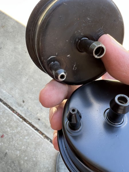

I got mine from mopar mall. It has the correct size return orfice. Somewhere I have a pic of the two in the market. One has a huge orfice that will lower your pressure. I’m sure all places source from same factory, so if 521 has the correct size it’s fine. IIRC it’s .060 and looks more pointed. The wrong size one is way bigger.
